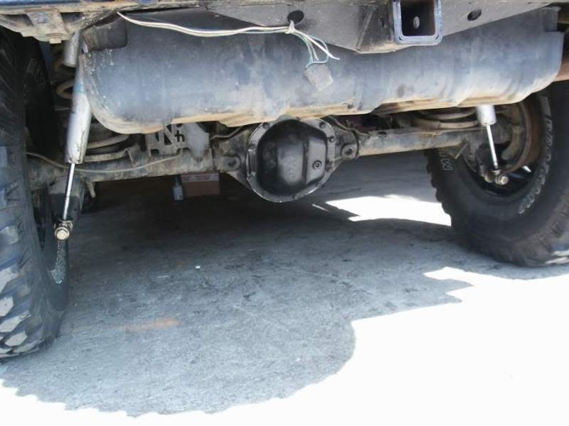

I would say it depends more on the type of terrain your jeep sees and what tire size you are running. If you are constantly flexing it to the fullest you will kill your shocks pretty fast.
I have been running the 3.25 on my LJ For almost 2 months, i dont do anything TO extreme, but love running forest roads and what not. I have not got around to adjusting my bumpstops yet, but am planning on it very soon. I am still running 31's, but as soon as they wear down i am going 33. With 33's i will have to have a larger bumpstop or i will rub at full flex
In this pic i am just barley touching my rubber bumper on the shock, not compressing it yet.

I have the 1.25 bl also, so I am not worried about rubbing at full flex, just wish RC would of mentioned this kinda info on their site for the lift, and also again when they sent out the 'newer and better' shocks that were suppose to fix this problem...
IMG]http://i260.photobucket.com/albums/ii24/Danisan23/P6130017.jpg[/IMG]
you'll need 2" stops up front without a bl, 1" with a 1.25" bl which is about right for the front rc shocks.
the rear just needs to match the shocks, 33's fit and stuff in the rear wheel well with stock bumpstops, although the 24" rc shocks need close to 2.5" extended bumpstops on the rear.
running the 3.25" lift gives you more uptravle and is a closer match to the rc 24" long shocks, I'd still put outboard lower mounts on it to gain more and reduce the amount of bumpstop extensions on the rear.
