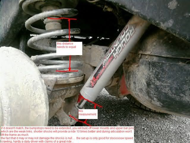

So i just scanned through all the post and i dont recall seeing what the measurements were on the proper short shocks... any one got them handy?
23" extended, 12.75"? collapsed... could be 13" I havent seen actual measurments yet either..

Well I took off the old shocks and compared them with the new one.....not too much difference really, idk how much it will help. Still shorter distance than it takes for my bumpstop to hit:
Same here. I thought mudb8 cleared it up for RC with this picture, but apparently not.
Here are the measurements.
Code:
          In          Out
Stock    12.1"      19.25"
Old RC   16.5"      24.9"
New RC   15.75"     23.5"
While on my wheel ramps i have 3" for the shock to hit the shock bump stop and 5.25" before the axle hits the bump stop. D'oh!! Looks like i'll have to make my own shock mounts to get what i want. Oh well, you get what you pay for.
I'll post a pic when i get around to it.
Also i thought these were supposed to be gas charged shocks. Don't gas charged shocks extend on their own? Every single shock i've dealt with has extended on its own to max length, except for these "china" shocks.

So these shocks are not gas-charged as stated on their site, and the new shocks still have too long of a shock body to run with this lift? RC please chime in.
