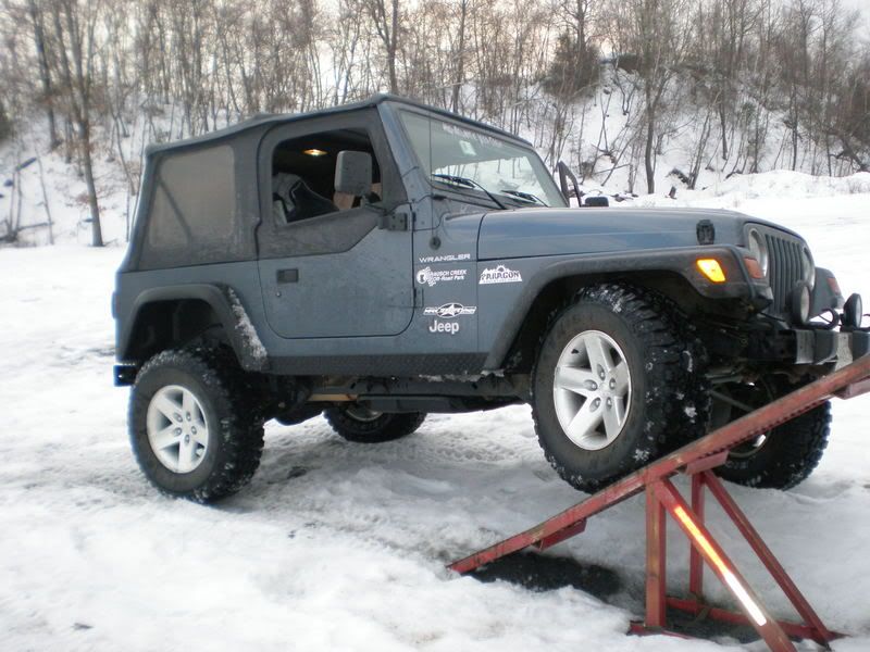

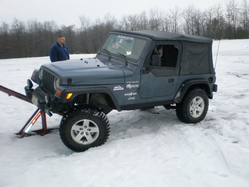

Originally Posted by [ITA]Tsunami
Thank you, some pic would be good! After installing them yesterday i noticed that the can doen't reach neither touch the spring bucket, btw it's really close to it. But i have to see how it is under flex (this weekend).
it wont touch....
didnt touch when i did this..
