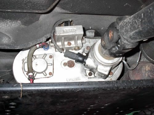

Well....On my jeep my drive shaft looks like this.
And yes. Just remove the bolts for the straps and the drive shaft will just fall out. Be carefull not to lose the caps on your u joints. I put tape over them when I take it in to have them rebuilt.

The black boot on the transfercase side stays in place. If you take off the metal clip going around the boot, you should be able to pull the drive shaft straight out.
