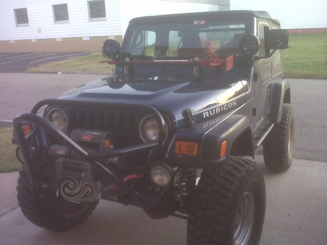

Originally Posted by GOLENJEEPTJ View Post
Sorry... I like the 5.5" "stupid tall... after a small sag over time and all of my winch and armor, it works great.I didn't want a body lift at all! I love the tri-link that I added with it.It works well for me.IMO!
I've been thinking about doing the tri-link, and building my own truss. Do you have any close up shots of it?

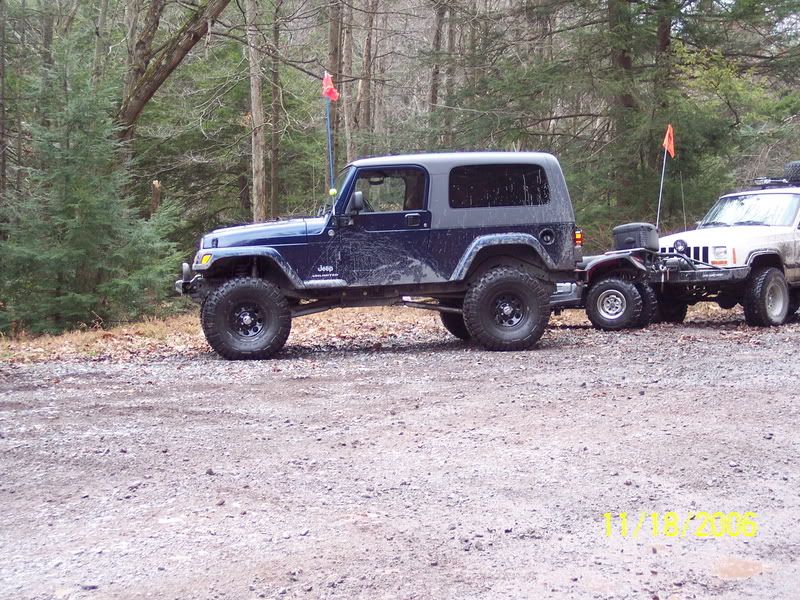

Not the best but it'll get you started:
http://www.jeepforum.com/forum/f9/diy-alignment-kit-steps-w-pics-2264465/
In my picture gallery.
GOLENJEEPTJ is offline
post #23 of 45 Old 08-03-2010, 03:04 PM
EricRollerSkate
Location: New Jersey
Posts: 276
Very cool. Thanks guys.
