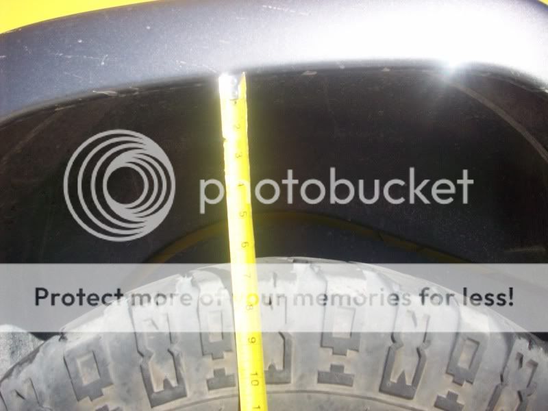

For those of you who trimmed your fender flares. Did you trim a portion of the inner part of the flare also? I trimmed the outside one inch and noticed that at the bottom of the flare, near the door, I could see the inner portion of the flare. There is also a small portion near the top I can see. Should I cut this also? Thanks in advance.

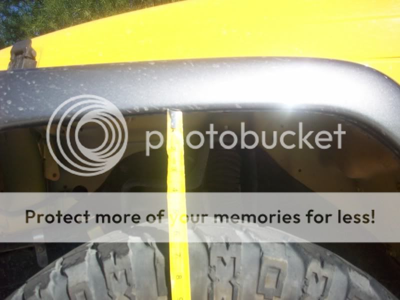

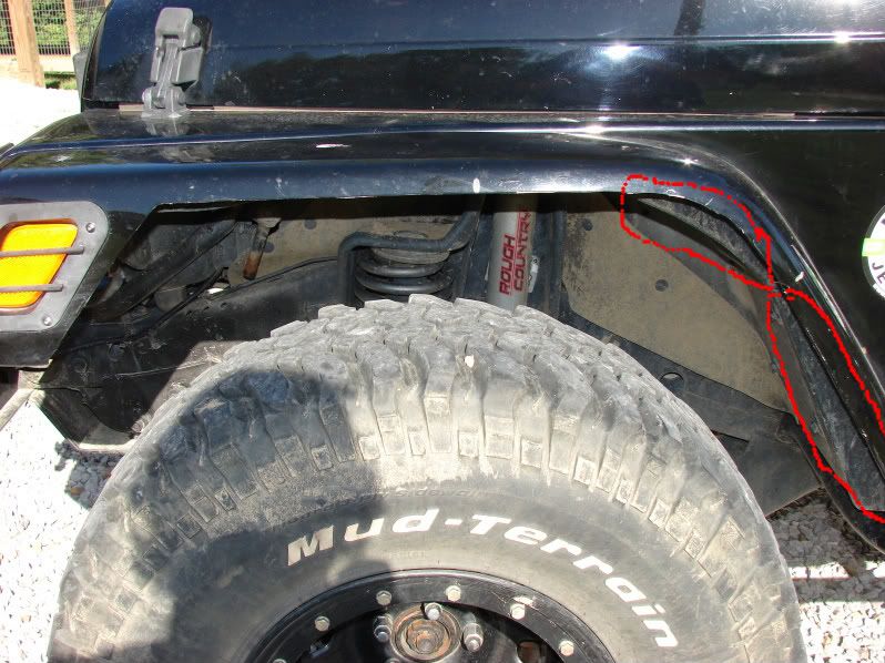

I understand what you are talking about. I started to trim my rear fenders and didn't think I would be satisfied with the inner part going past the trimmed part.
I just trimmed the front and it is barely noticable.
red circles show the inner fender portion that you are talking about
hope this helps

Exactly, thanks. That portion has a lip on it which I believe is supposed to be a guide and rests along the inner fender wall. My stock flares dont seem to touch it however, so its not so much a guide as it is a guideline, where mud an rocks can rest. I will post some pics here shortly. Working graves and teaching college on the side, so I'm only working on it in short sessions.

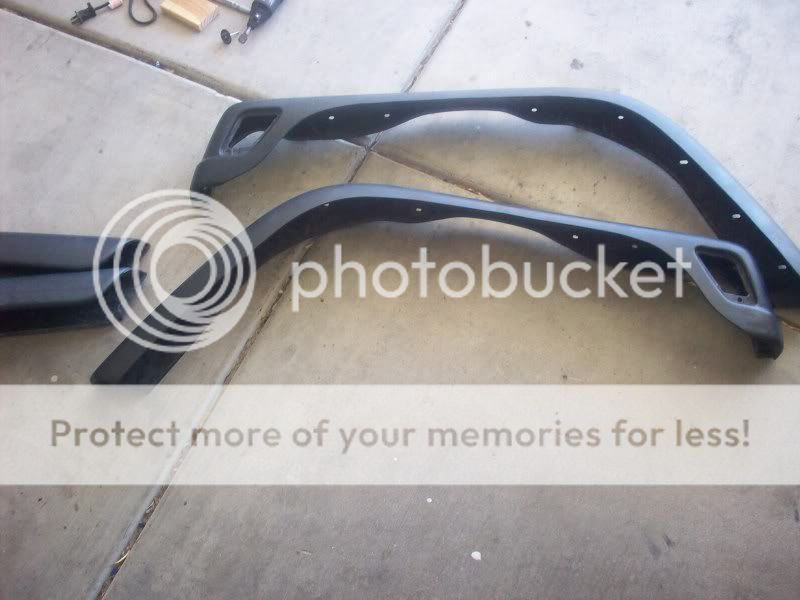

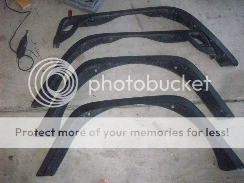

I didn't want to cut the flares that came on my RME so I picked up a set off Craigslist for 75 bucks.

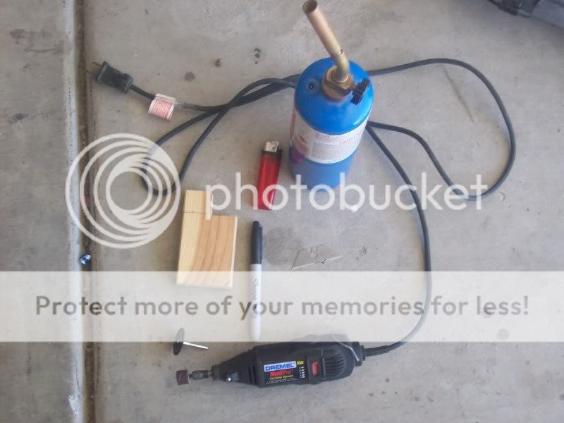

Heres the tools I used.
I cut the stock flares 1 inch using the wood block guide for marking and then used my Rotozip, with a hard cutoff wheel to cut. I then used the little drum sander to even everything out and a razor blade to shave off some interior plastic that was showing. I used the torch to melt the very minute shavings left by the sanding. While torching there were several small scratches in the plastic I used the torch to melt the scratches by patiently heating and cooling it. Hopefully paint will cover the scratches.

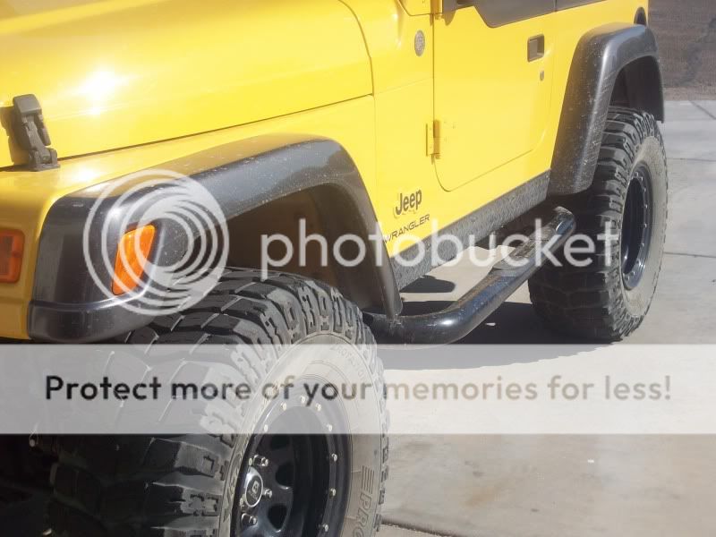

Ok, got the old ones off and the new (to me) on. The rears were a PITA till I figured out, you take out the rear fender guard then, you can get to the plastic nuts that are on the screws.
I used Rustoleun satin black for plastic because the local ACE was out of Krylon and Lowes didnt carry it.
After putting the Satin on I realized the area I sanded was coming out smoother so I put a coat of Rustoleum hammered black on thin, then finished off with a coat of Satin.
I went wheelin prior to taking pics so the flares are a bit dusty in the photos. But, here is the final product on.
