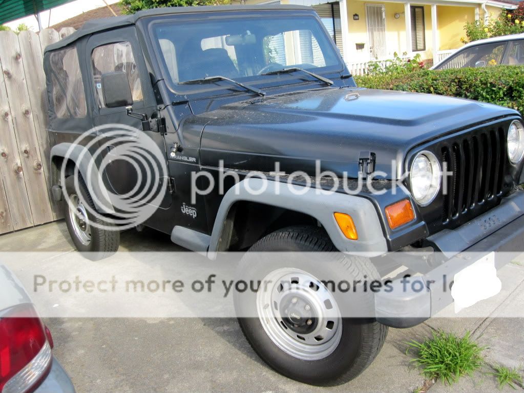

So I'm looking forward on swapping out my stock tires for some AT tires.
I have a Jeep 97 2.5L 4cyl Auto. Also want to know how big can I go, In terms of tire size also what brand you would recommend? I don't want to lose a lot of power on the freeway. With current stock tires I can go 90mph on the freeway.
Thanks in advance
