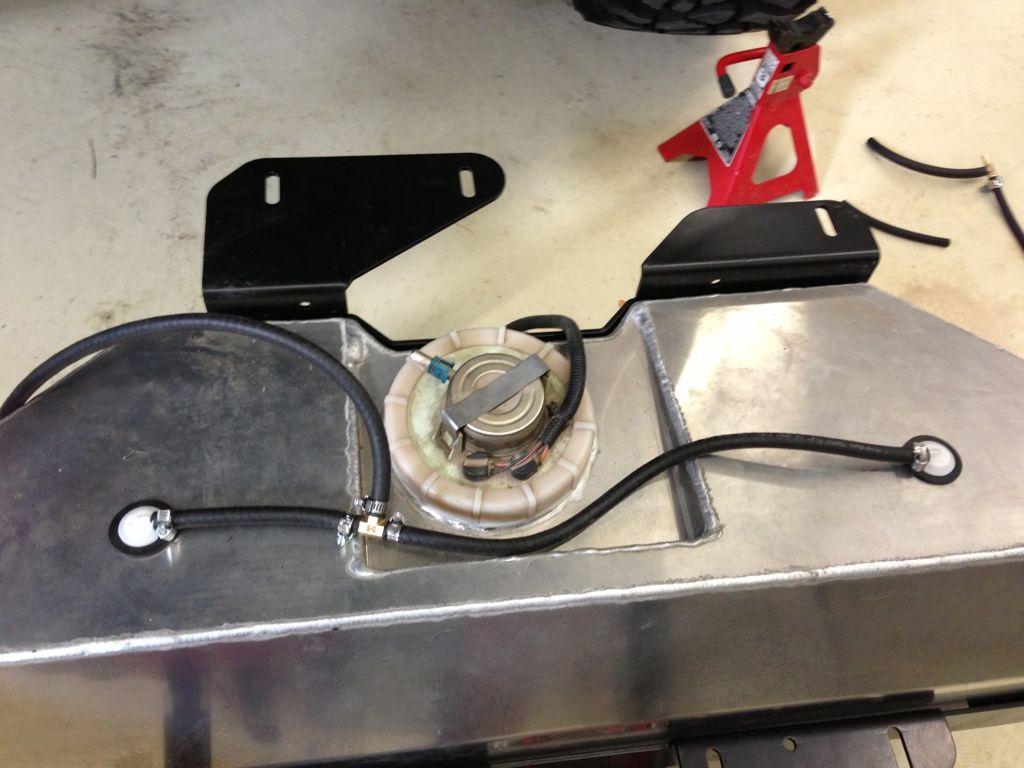

Yeah I've got a bad taste in my mouth and I'm not even finished installing It took me 7 weeks to get the damn thing. Around 6 weeks, I emailed Gerald and told him to cancel my order and I was going to go with the Genright because I confirmed they were in stock and would ship the same or next day. Unfortunately, the tank had just been shipped out so I decided to keep it. I need to go get some fuel line hose and another coupling and I will try to finish it all up this afternoon.

Ok guys, I'm all done. Jeep runs great. I decided to do it right and buy new hoses for the rollover valves. Autozone sells fuel hose by the foot. I used about 4 feet of 1/4" ID hose and then got (1) T-coupling, and (1) regular coupling to connect the new hoses to the factory line up by the frame. Keep in mind, this is on a 1998 so I'm not sure what everyone else will have. throw a couple of hose clamps on there(I needed 8 ) and you're good to go!
