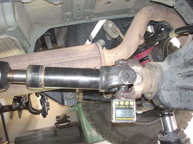

Yup degree measurements are correct, taken in the same exact spot every time. Digital angle finder from harbor freight, with a nylon washer and a rare earth magnet to hold it to the u-joint cap.
here's an example:
This is before regear & shaft rebuild...you can see the HP D30 in the background (no vibes in other words)
The keyboard sign is Alt+num pad 248 (thank mrblaine for teaching me that one)
EDIT: It's also not the tires...those were road force balanced and rotated...no change.
