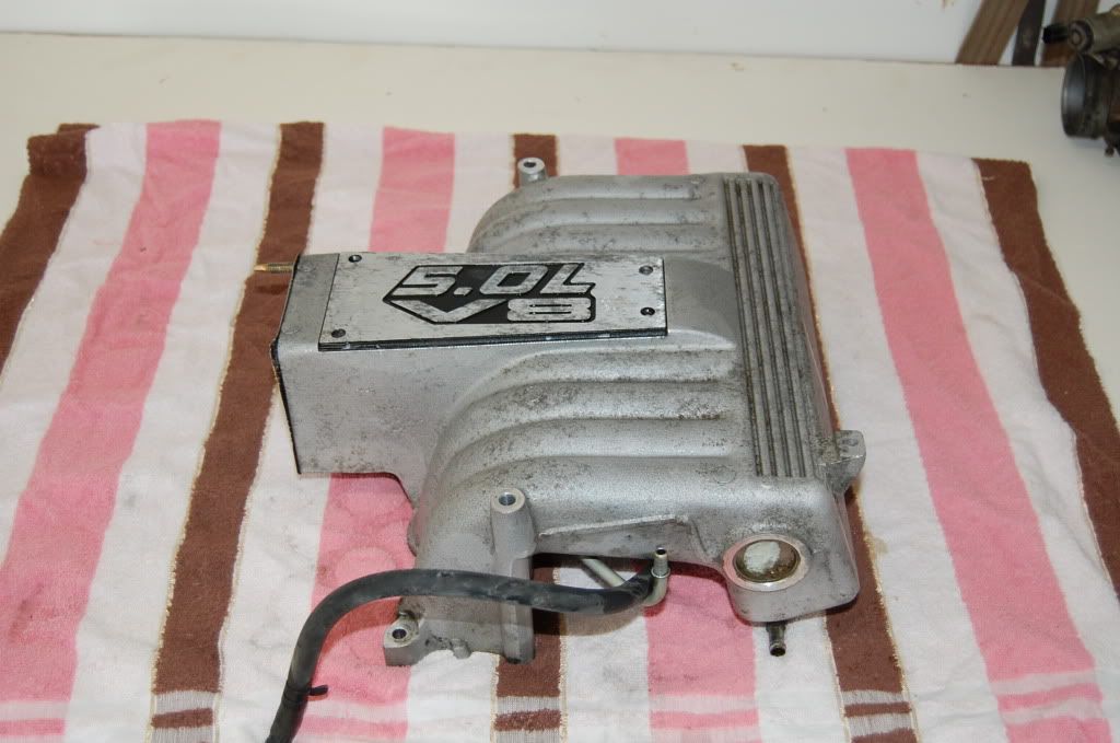

I finally bit the bullet. Just picked up a 5.0 to put in the jeep. I still have to pile up some other parts while I give this engine a good look over, but it won't be long until the pictures are flowing.
A special thanks to 472cid and sourskittle. These guys know the answers and I probably wouldn't even be starting this build had it not been for the info on 5.0 engine swap pictures thread.
Anyway, here's the first part of the puzzle, 98 mercury mountaineer 5.0!

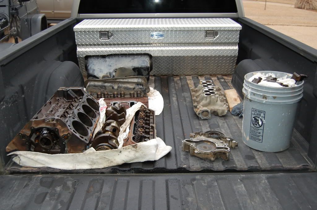

We got the engine torn down yesterday and took it to the machine shop to get everything cleaned up and checked out. Didn't look like much wear once we got into it but I figured I would go ahead and make it a fresh 5.0 now instead of later!
I wish I had of taken a pic of the oilpan. There wasn't hardly any sludge in it and this engine had 120,000+ miles on it....kinda unbelievable.

The guy at the shop took measurements of the cylinders and said they looked good and probably wouldn't need a bore so fingers crossed. I did tell him to go ahead and do a valve job.
I was debating over putting a different cam etc in this motor but the more I think about it, I think I'm going to leave it stock.....what do you think? Cam would equal valve springs, lifters, etc....more $$$$$
Once I get it back I'm going to "purty" it up with some paint. My buddy helping me says paint the block black and the more I think about it the more I like that idea, especially with the aluminum brackets on the front of the motor and intake against the black.
