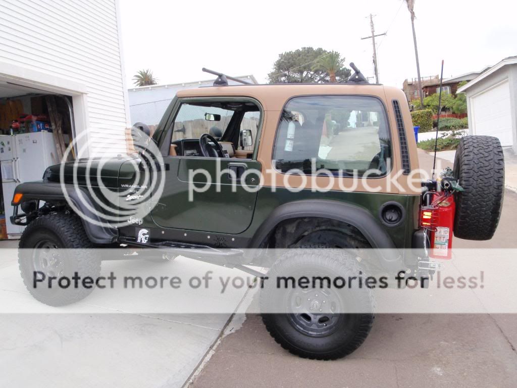

First thing I did was to get one of the Tuffy expandable trunks (needed a place to toss the laptop, etc. when the top is off)…and while I was at it – I put on the mirror relocation brackets so that I can’t see my passenger mirror anymore. Next came the Teraflex 4” short arm lift kit and 33’s. 33’s were supposed to work on the stock wheels, but when push came to shove I ended up getting a great deal on some American Racing Chamber Teflons – wasn’t sure how good they would be for off-roading, but now I see them in all the 4x4 catalogs… Tossed in a K&N Air filter (yes I know how some people here feel) so my engine can whistle when it accelerates. I’ll throw in some under-the-hood pictures later – I haven’t taken any yet.
Speaking of acceleration – I sure lost a lot of power – so next up was a re-gear to 4.56. Much better – felt like stock again in the power department. Watched Craig’s List for a while…picked up a spare tire extension, light bar with some lights, and some Bestop fenders for the larger wheels. The spare tire bounced around like crazy – especially on the freeway stretches with the segmented concrete. I kept it pretty much in this state for about a year and enjoyed the changes. I hit some trails here and there when I had time – started to get comfortable off-road again.

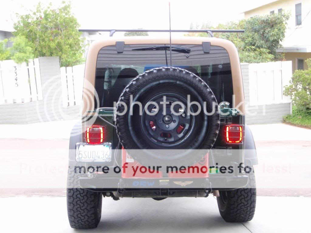

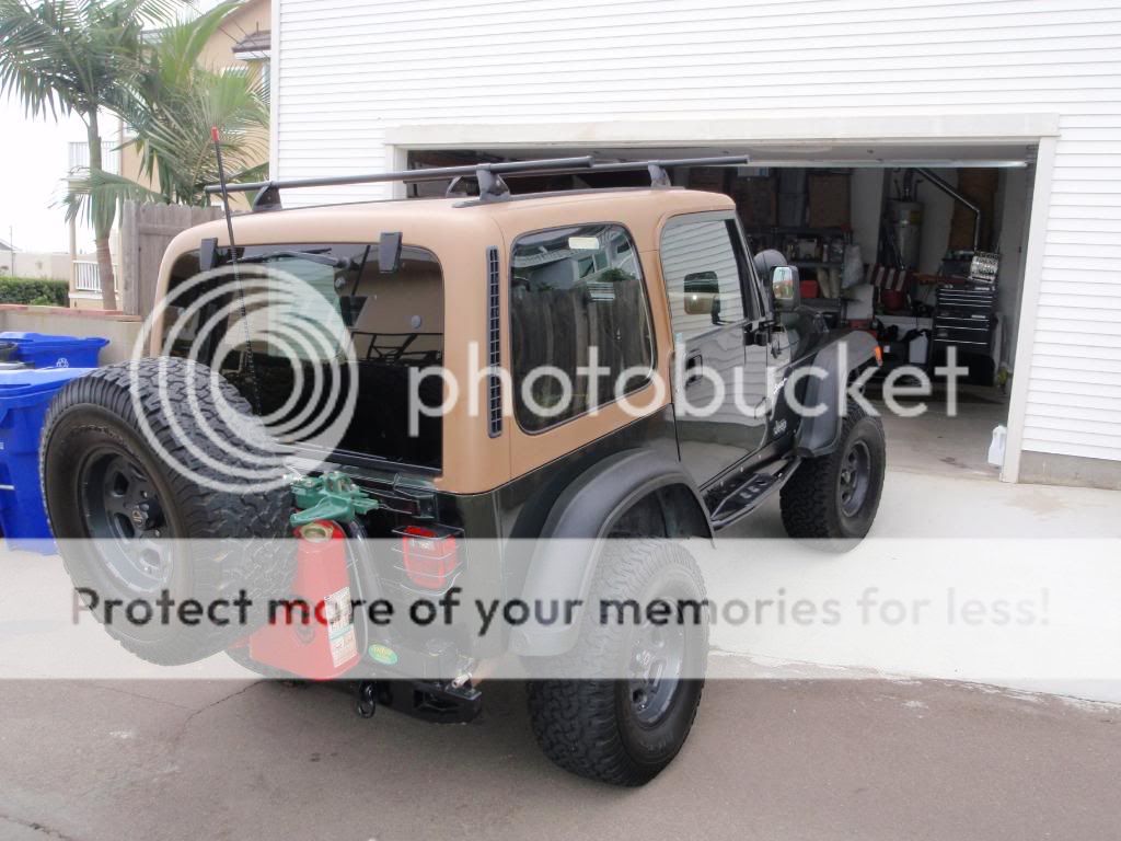

Next up was the Body Armor rear bumper – tossed the extender – along with some fuel cans, Hi-lift Jack, and some offroading lights on windshield brackets and front bumper (had to relocate the bumper ones when I got a new bumper later). Never did use the light bar – realized I probably wouldn’t fit in the garage and it’s better to get the weight lower anyway. Night runs out in the desert have been a lot of fun with the lights. Future project will be to add some rock lights – that will really be helpful from time to time. Also had the speedometer fixed finally to match the gearing and tires.

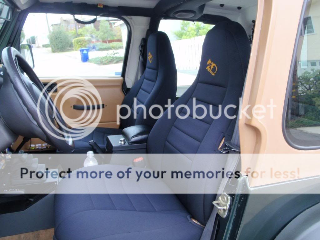

I have been a big fan of the Wet Okole seat covers for years now and always wanted a set. My girlfriend hooked me up for Christmas last year. (again, I know how many feel about the neoprene seat covers, but I love them and that’s all that matters <shrug>).

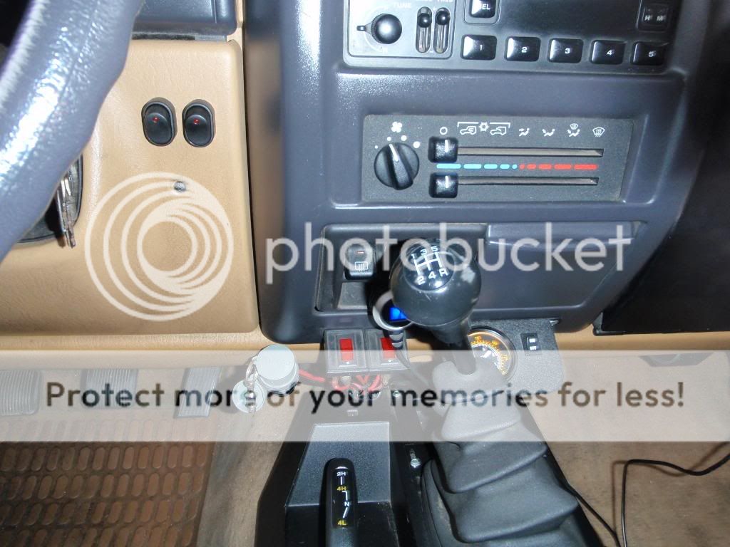

Got the itch again a few months later and started my next few upgrades. I finally got the Tuffy Center Console and Glove Box (this damn thing rattles like crazy – still working with Tuffy to fix it…they are shipping me some rubber stops next…we’ll see how that works)…but I love the center console. I also added a hood lock. I had been thinking a lot about security for the Jeep – and the more money I put into it, the more I worried about it – so after a lot of research, I went with the Ravelco and now I don’t worry so much – I have done what I can to protect my investment, no use losing sleep over it.

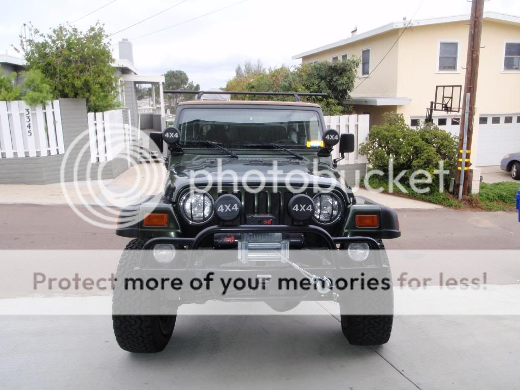

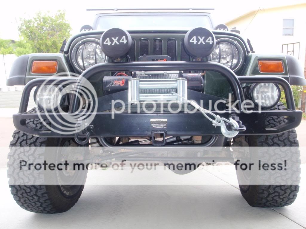

I also threw in an Optima Yellow Top, Body Armor Front Triple Hoop bumper, Winch plate, and the Smittybilt XRC winch. I also hated having to ask everyone for air at the end of a long day of trails and for a deflator at the beginning so I picked up some Staun deflators and had a Vaiar Heavy Duty Onboard Air kit installed with hook-ups in front and back.

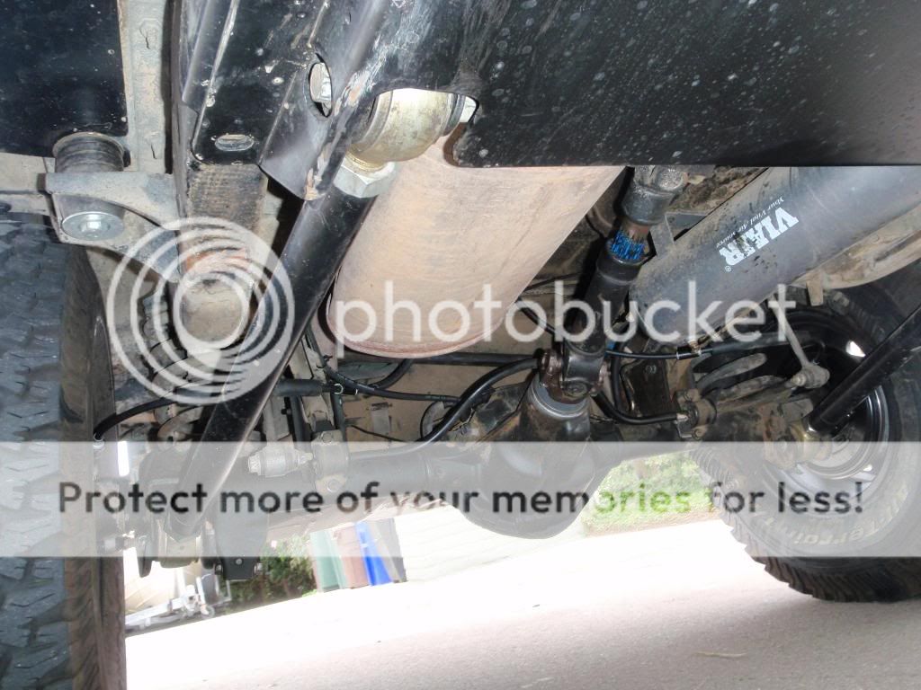

It wasn’t long after that the Heep developed the infamous Death Wobble. At about 45mph if I hit a bump or turned the wheel with just a little uneven pavement…well you know… Did the usual alignment, balance tires, etc..and while it all helped a little…it was still there. Ended up using this as an excuse to upgrade to a Teraflex Long Arm upgrade kit, a belly up skid plate, new steering bar, heavy duty tie rod, track bar, swaybar, and a 1” body lift. No more DW.

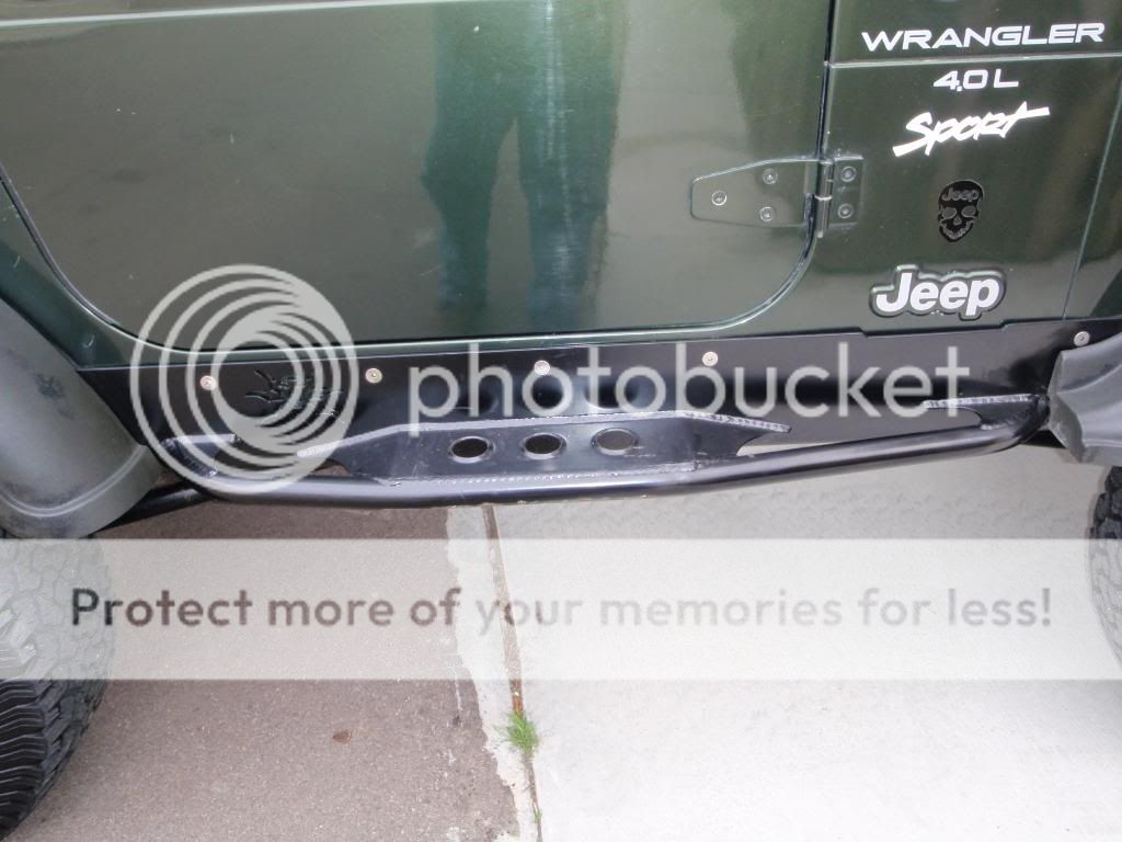

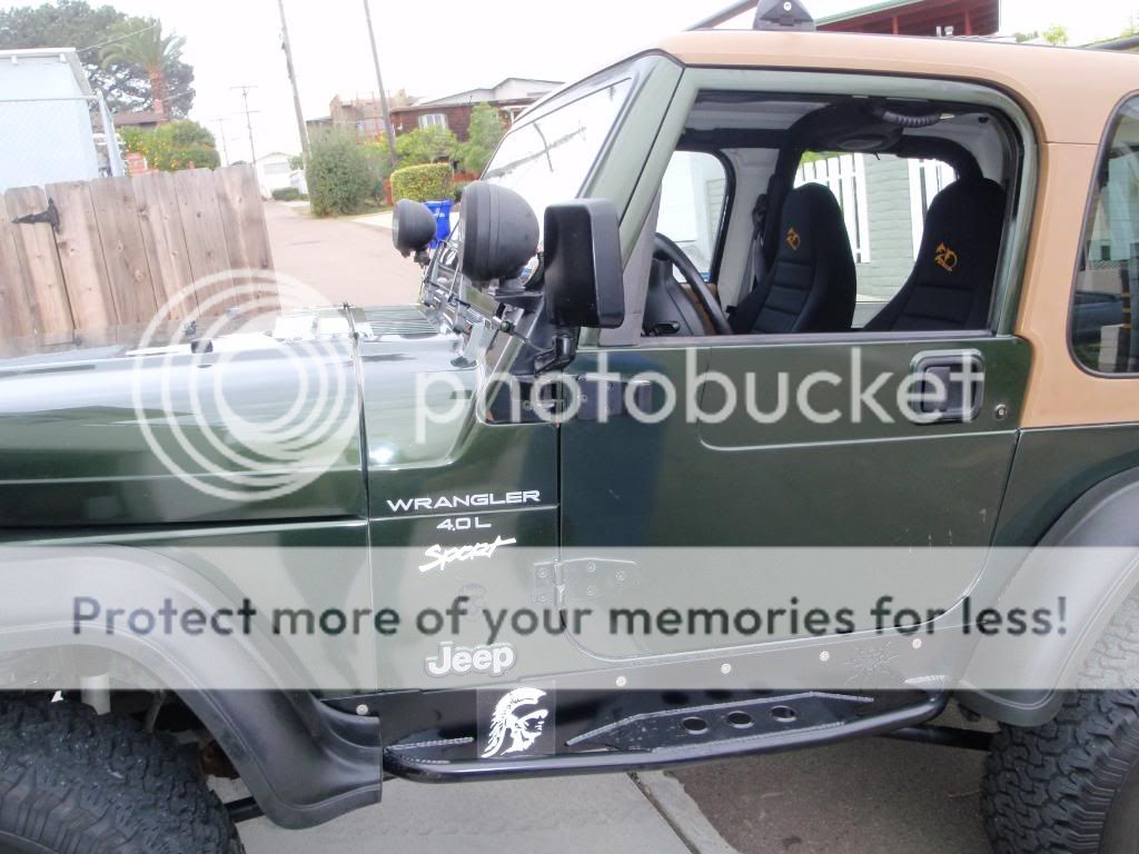

I finally ditched the stock steps and got my coveted Poison Spyder Ricochet Rockers from Oconee Offroad – they had a good deal and customer service was great! Found out that the body lift I just had done wouldn’t work with the new rockers so I had to have it pulled and replaced with a Daystar 1” body lift. Wish I had known that ahead of time.

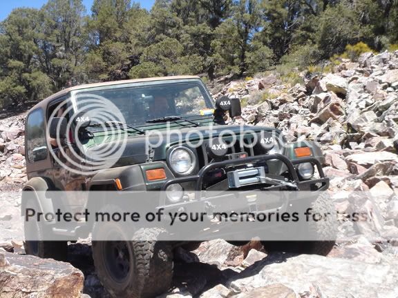

That’s pretty much where I am at today. I’m sure I left some stuff out…but I think I hit all of the important points. What’s next? I need to slow down on my Jeep spending for a bit…but eventually I need some rear corner guards, maybe a dual battery setup, a mean green alternator, perhaps a snorkel – though I haven’t found a lot of water crossings around here like I used to in Northern California and Florida. I’ve already ordered a Kilby gas tank skid plate…and I will probably get some differential armor – bombshell covers or something. I also want to add one of those pull-out awnings like ARB or Hannibal make to attach to the side of my Megawarrior roof rack. One day I may end up re-gearing back to 4.56 (Rubicon axles were 4.10) or going up to 4.88….perhaps when I wear these tires out and contemplate 35’s…hehe. Maybe a new cage or even just a sport cage kit. This is my daily driver and I take clients in it occasionally and the GF already has trouble climbing up…so I can’t take it much higher. I’ve tried to strike a good balance between building a very capable machine off-road in the rocks, sand, and trails and not going too over the top and maintaining it as a great daily driver and good looking vehicle.
Now I need to sell off some parts….that light bar with the old lights, the teraflex short arms, D30 axle geared 4.56, D35 rear axle geared 4.56 without the brakes, stock transfer case, bumpers, side steps, spare tire extender, spice colored center console, and spice colored stock glove box. That’s off the top of my head – might be a few more goodies in there…feel free to make me an offer! If you want pictures of any of the items, I can add them.
I’m happy as heck with what I’ve done so far and I hope you enjoyed my project thread – am interested to hear your thoughts and see your comments - see you on the trails!
