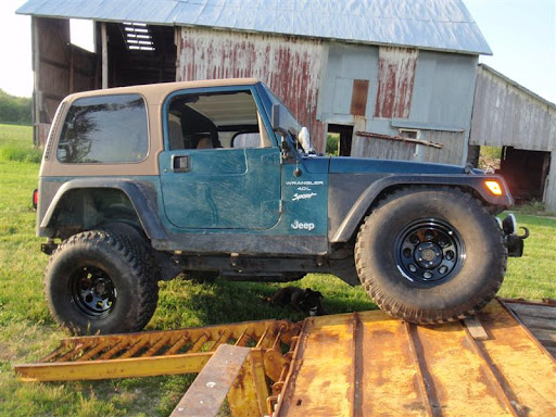

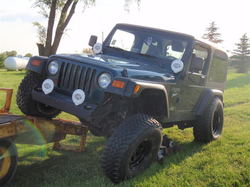

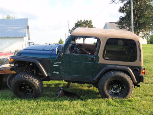

This thread seems like it is dead but we'll try to get it started again. Here is my low COG '97 TJ. I have a 1-1/4" body lift and stock suspension. I get clearance from a DIY highline hood/fender. I am currently running 35" BFG Mud Terrains. It took alot of surgery to keep the tires from touching but after quite some time with the sawzall we are all good. I am still on stock bumpstops also. Next, I will be adding a high clearance belly pan of some sort. So far, I am extremely happy with this set up. It runs great on the road and holds its own on the trails.
Enjoy the pics!

click free...any pics of it just sitting?

None on me. I'll get some up in a day or so when I'm back home.
Do I have to pay a membership fee to make my pics click free? They showed in my preview but not in post.
