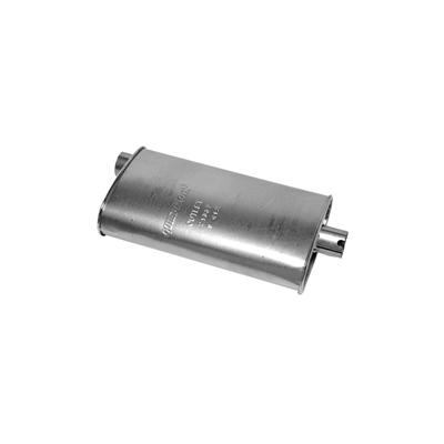

Catalytic Converter:
Walker 15841 97-99
Muffler:
Walker 21337
Tail Pipe:
Walker 54227
Now my plan is so cut flange off the head pipe and use an adapter or expand the pipe so it fits with the cat. Any one think this set up will work my only concern is the length of the head pipe and the length of the cat.
