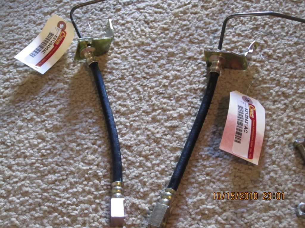

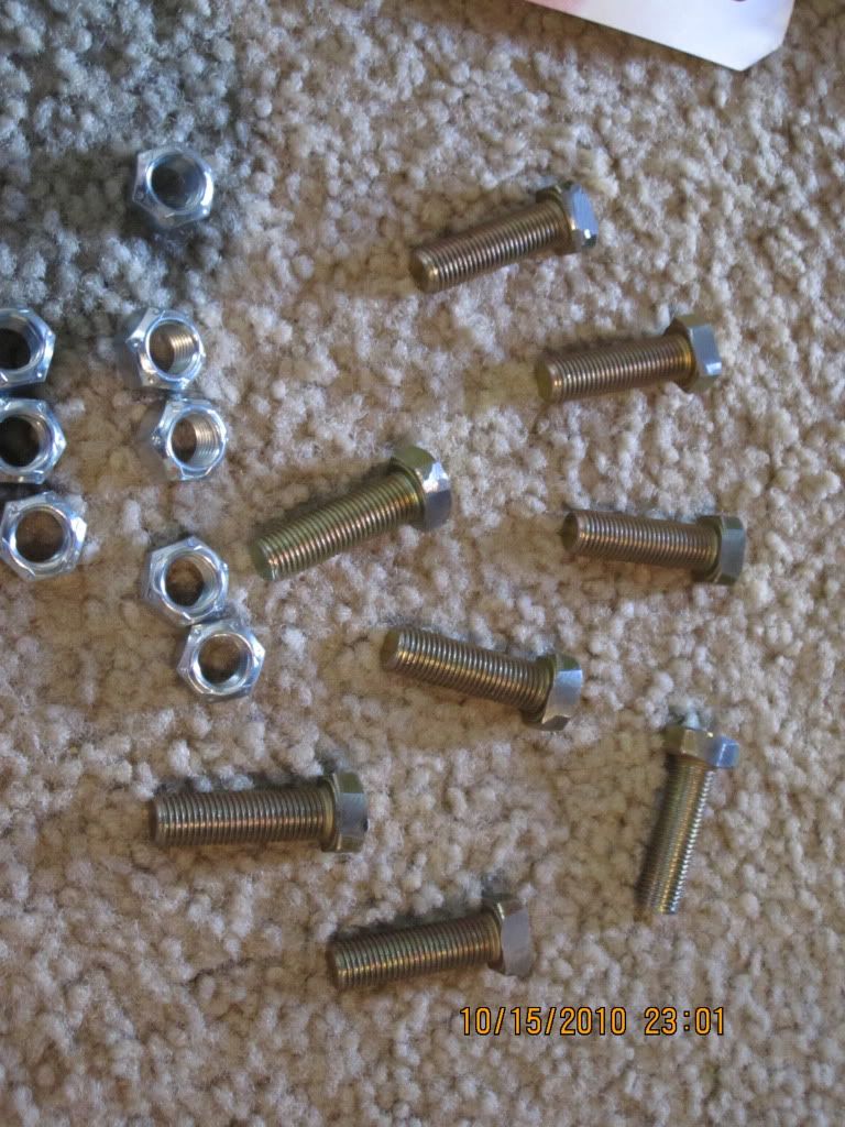

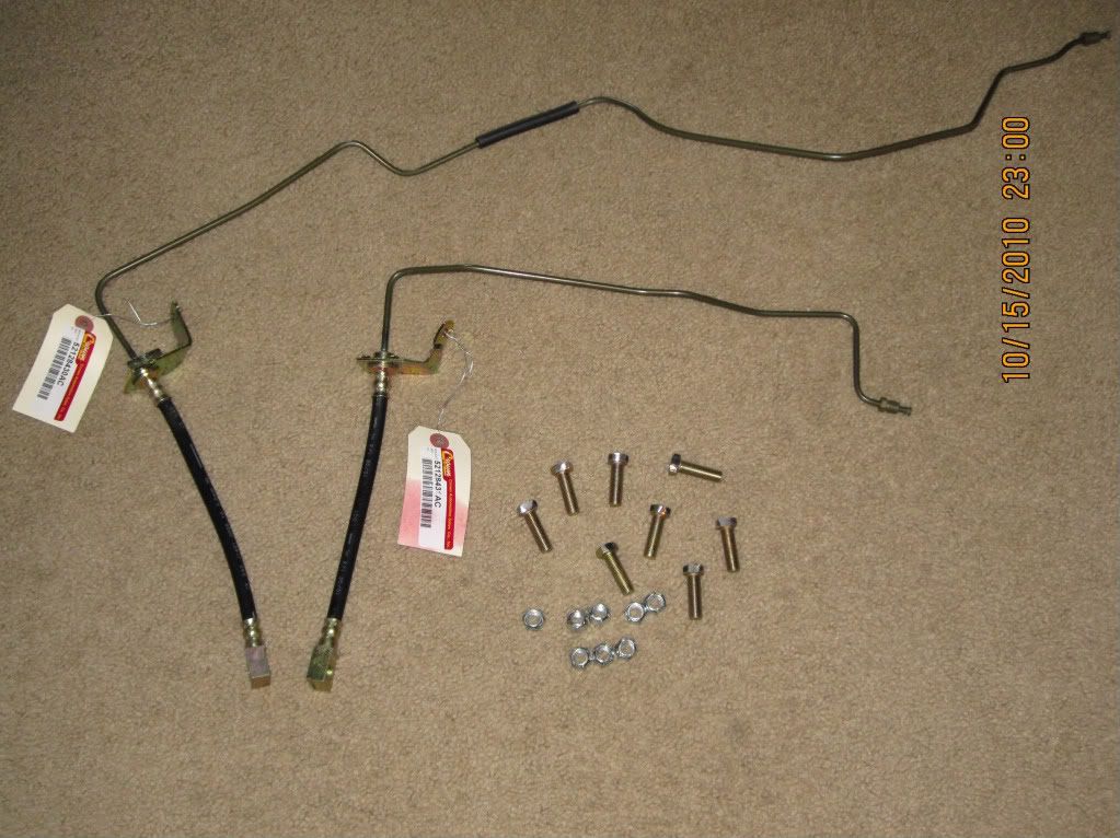

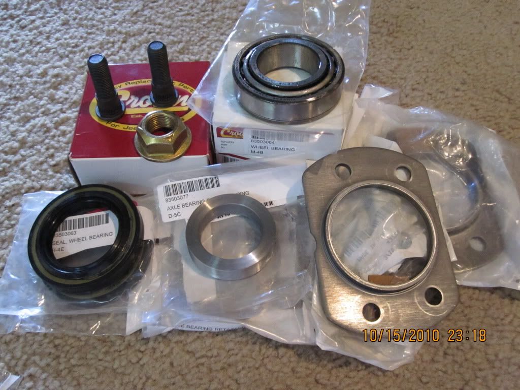

So I got a great visit today from the Fedex guy. Also, yesterday the UPS guy delivered my Brake hoses and lines from Savvy (pic below). Fedex brought me all kinds of goodies today. Pretty much everything I need to finish up the axle shafts (pics below). I got new seals, bearings, retainer plates, retaining rings, a new pinion nut and 10 disc brake studs. Speaking of disc brakes, I just got back from a junkyard and got my conversion off a 97 ZJ. Read my other thread here on pulling them from the yard.
I also got my 8 flange bolts grounded down on the sides to fit and the upset locking nuts.
Almost there fellas!! Im excited

Hey does anyone have a link on how and what order these pieces get installed on the shafts?? For example...What direction does the 4 bolt retainer go?? Which way does the seal get installed?? Which side goes up on the bearings?? I dont want to install these pieces then have to turn around and reinstall them correctly. Thanks
Stu's site has a pic for you.
With the shaft spline end up. Drop the parts on in this order and orientation-
4 bolt retainer with the formed lip facing up
Oil seal with the open end facing up, seal end down
Bearing with race up. There is a line around the bearing where the race separates from the bearing. That line is closer to one end, the end with the line closest to the side goes down which puts the race up.
Shaft collar. If you can find a difference in the sides, put the pretty side up. Otherwise, it goes on either direction.
Press the bearing on first with the other pieces in place, then press on the shaft collar. Before you slide the oil seal on, fill the small space between the two seal lips with some axle bearing grease so you aren't starting it dry.

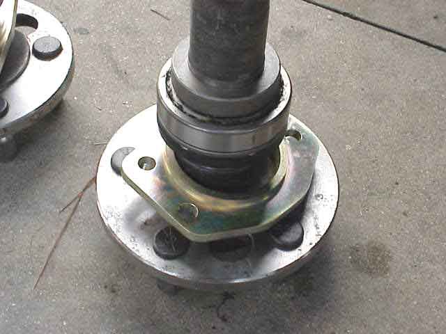

So according to stu's pic and the pic I posted here of the bearing. The way I have the bearing sitting there on the box. Is the way it goes on the shaft??
Stu's pic
tcoche is offline
post #88 of 144 Old 10-16-2010, 10:38 PM
mrblaine
Wizard of Brakes
mrblaine's Avatar
Join Date: Dec 2004
Location: Quail Valley
Posts: 30,790
Stu's pic
I love helping folks, (contrary to popular belief) but I draw the line where help stops and silliness takes over. You're being silly, quit it. You know damn well that's how it goes.
