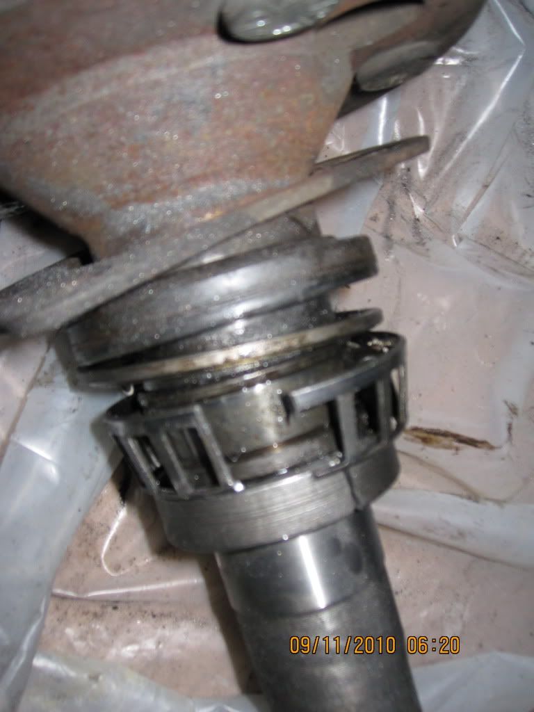

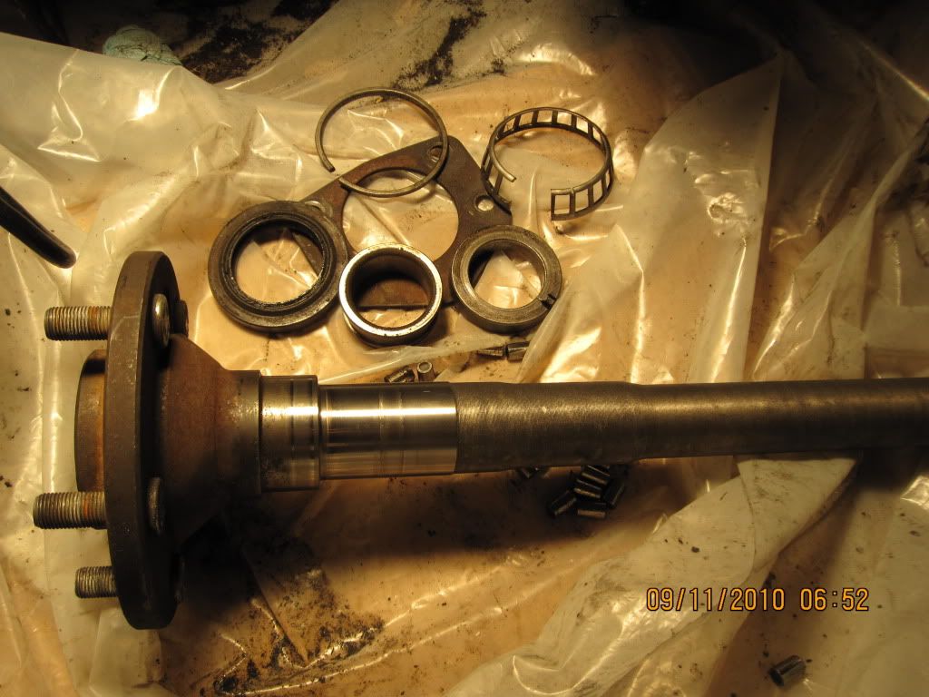

Update:
So I got tired of the monotonous sanding and wire brushing. So today I decided to switch it up for a moment. It was a nice change. I took off the drum backing plate and pulled out one of the axle shafts. I dremmeled off the bearing and shaft collar. I also slid the axle seal and 4 bolt retainer plate off. Surprisingly, it didn't take long at all. Saved me some money rather than taking it to a shop to pull them off. I have to buy new ones anyway..soo the cutting began. I did manage to nick the axle shaft with the dremmel cutting wheel though. oh well! The d@mn thing hit the edge off metal and jumped off and barely nicked the shaft. You can see the small nick in the shaft below. It isn't bad at all. I cut the shaft collar to the very bottom making sure not to go through. You can see in the 2nd picture the collar how close I cut down through it. While it was just about through, I made another cut to the side of it. I then put a flathead screwdriver in the slots and knocked them with a hammer. My idea here was to get the small metal left at the bottom to crack. Which it did. It then slid off with ease. I then slid off the other pieces. I will have to pay a shop to put the new bearing, seal and shaft collar on because I do not have a press. Atleast I saved money cutting them off. I'll probably do the other shaft tomorrow.

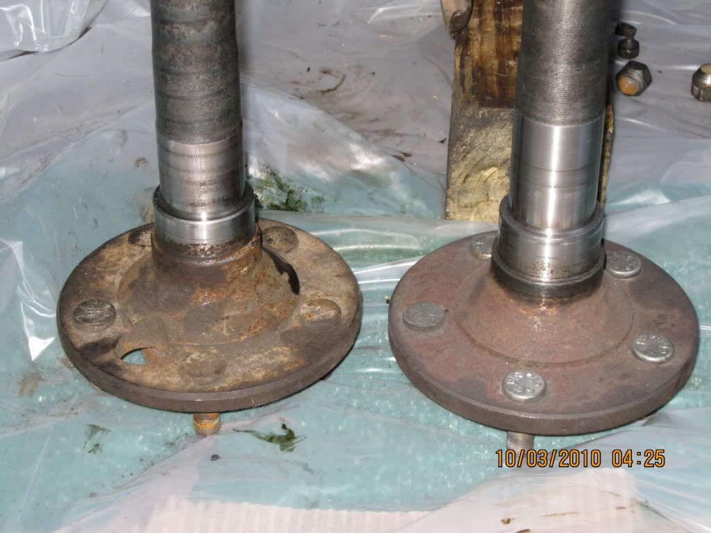

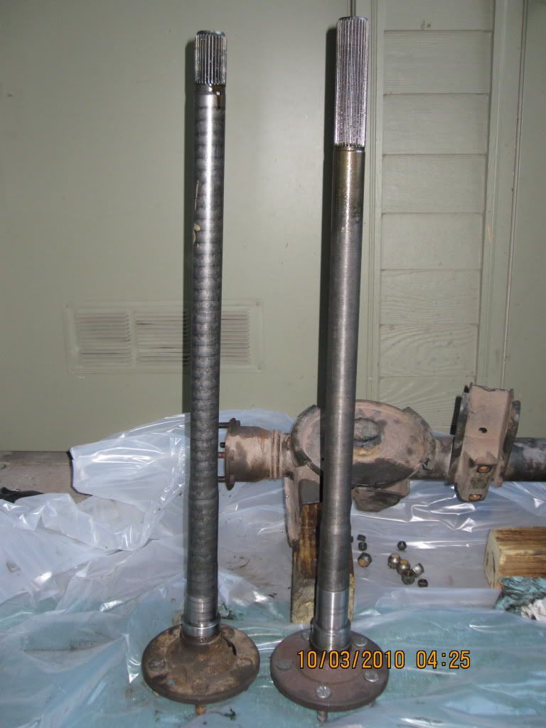

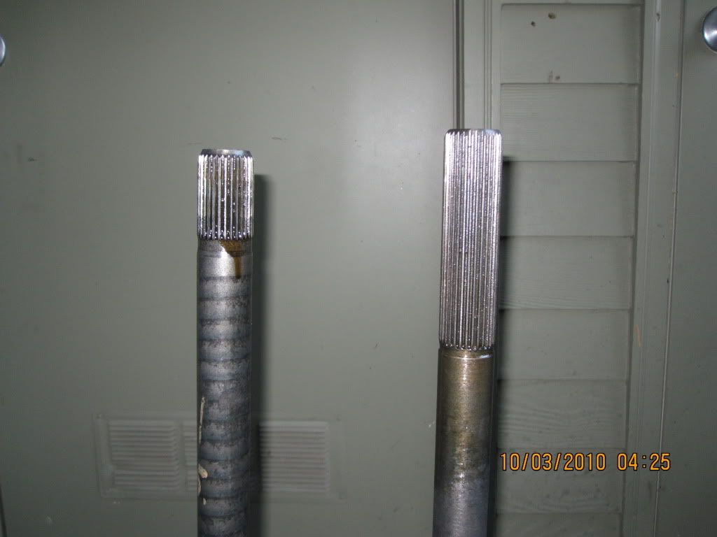

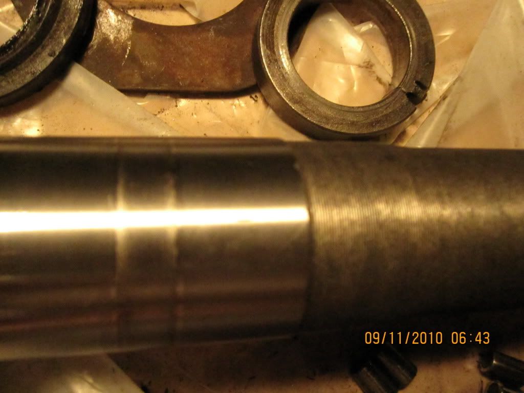

Update: its been awhile since I worked on the axle. Got busy doing other stuff. Plus, I was installing and prepping the "groundpounder" bumper/tire carrier.
Tonight, I took out the other axle shaft and dremeled off the collar, bearing and axle seal. Looks like I have 2 different axle shafts. Could the one with the longer slots at the top be the "chromoly" shaft?? Is it ok to run 2 different shafts like this??
Next up, purchasing new bearings, seals and shaft collars. Then I need to change the pinion seal, find and install disc brakes and then paint.

Yes, you will be fine running those axles. I wouldn't bet one way or another on the one with the longer splines being chrome moly. It is aftermarket though. The other one is a stock axle.
If you're doing rear discs, you will need the Rubi version of the 4 bolt retainer. Yes, bearing, oil seal and shaft collar. Question the vendor to make sure you get all the pieces. Sometimes the seal is separate.
At this point though, a decent way to go would be to order from someone like Superior and get a set of their shafts. They will come with studs, all bearings and seals and can come installed if you let them know what you need. (any vendor should be able to do that) That will let you keep the current axles as spares and buy you some time to get the bearings and stuff put together.

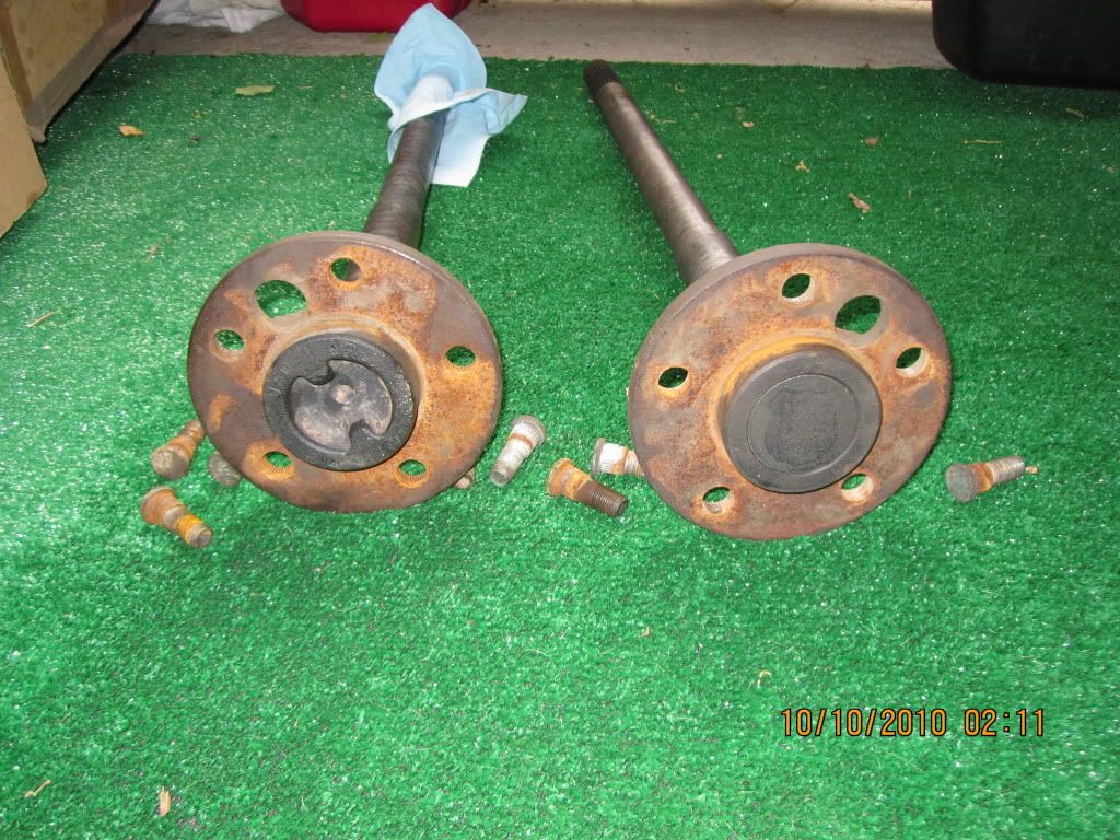

Continued a little work on the 44 today. I went to sears and bought a 3lb craftsman sledge hammer. Knocked all 10 of the studs out of the axle shafts. Getting ready for monday morning. I will be ordering all the pieces parts I need for the shafts from Morris 4x4 center. They have a blown up Dana 44 axle. You can scroll down and match up the parts you need. I'm getting the seals, bearings, retaining rings, new 10 disc brake version studs and the 4 bolt retainers. Getting closer!!

Looking at that last pic, it appears the one shaft is a Yukon. Look at the end, the shape of their logo is still there.

The other one is stock. No one that I've ever seen in the aftermarket does the drive indentation like that.
