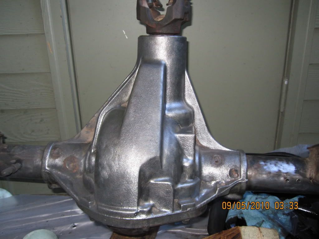

post #59 of 144 Old 09-05-2010, 10:52 PM Thread Starter
tcoche
Location: Littleton
Posts: 640
here is an update of work completed today. I'm going to use the dremel in those hard to reach corner areas. So when I'm done going over the major areas. I will hit those tight areas with the dremel. Its getting closer....
before:
after:
tcoche is offline
post #60 of 144 Old 09-05-2010, 11:01 PM Thread Starter
tcoche
Location: Littleton
Posts: 640
I also have a question. I noticed something that happened today. Can anyone tell me if this is going to be an issue. I noticed a couple holes that appeared after going of this area with the wire brush. It must have ripped off a chunk and left a little hole. Is this a problem?? It is also on another area in the same the area. So I have 2 holes. Should I plug it up with some JB weld or not worry about it and let the numerous paint, primer and clear coats cover it up??
tcoche is offline
