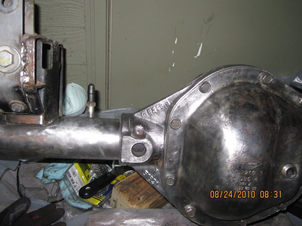

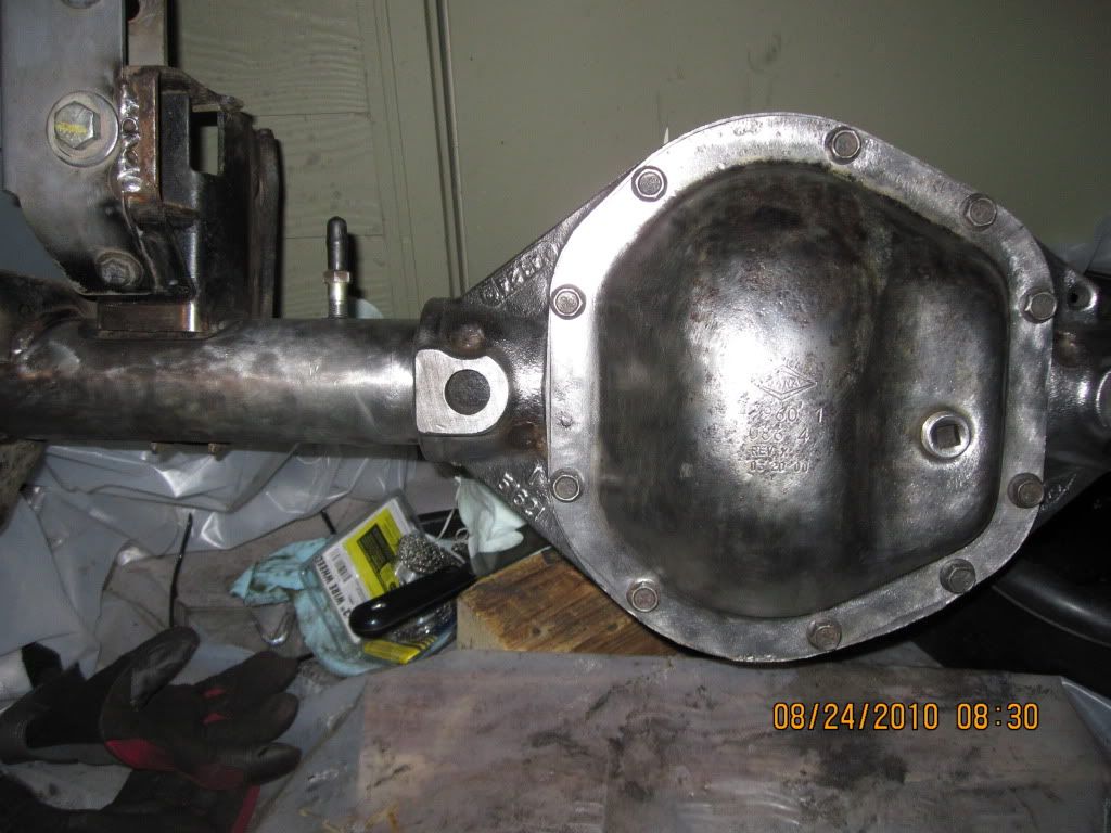

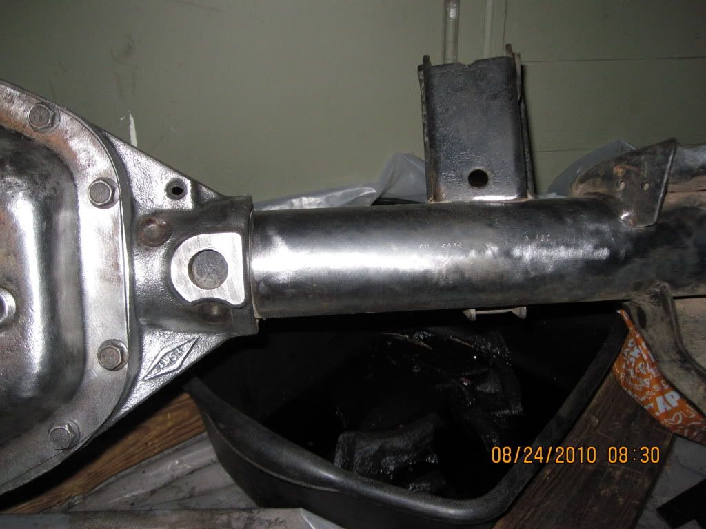

update: just finished up a round of wire brushin (see below). I can't get the rust out of the divot areas. Oh well. Its still coming out to my satisfaction. I took last night off. Can't really get much done with a little one. I did manage to work about 1.5 hours on it tonight.
