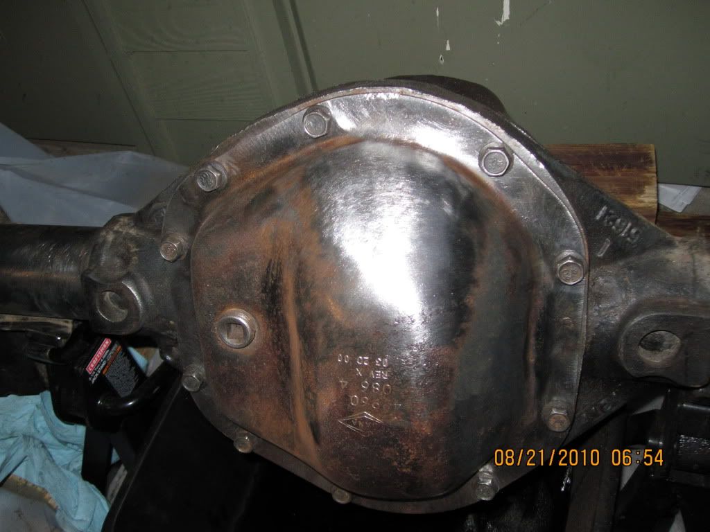

well I take that back I'm not finished for the evening. I got excited about these other wire brushes I got and I wanted to try em out. Low and behold they work fantastic!! This is probably 5 minutes of work. I might finish the diff tonight...if I can see! Its dark outside and I don't have a garage so I'm working on my patio...

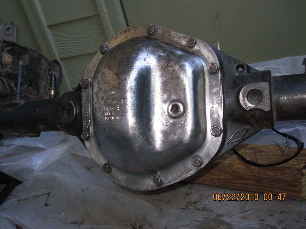

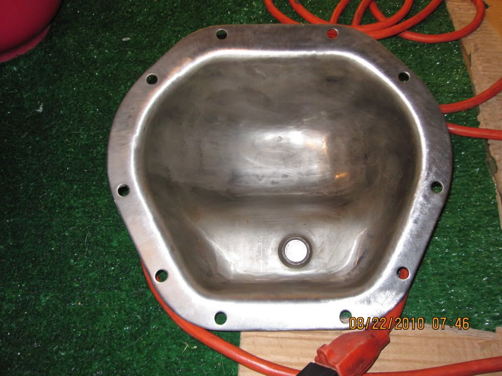

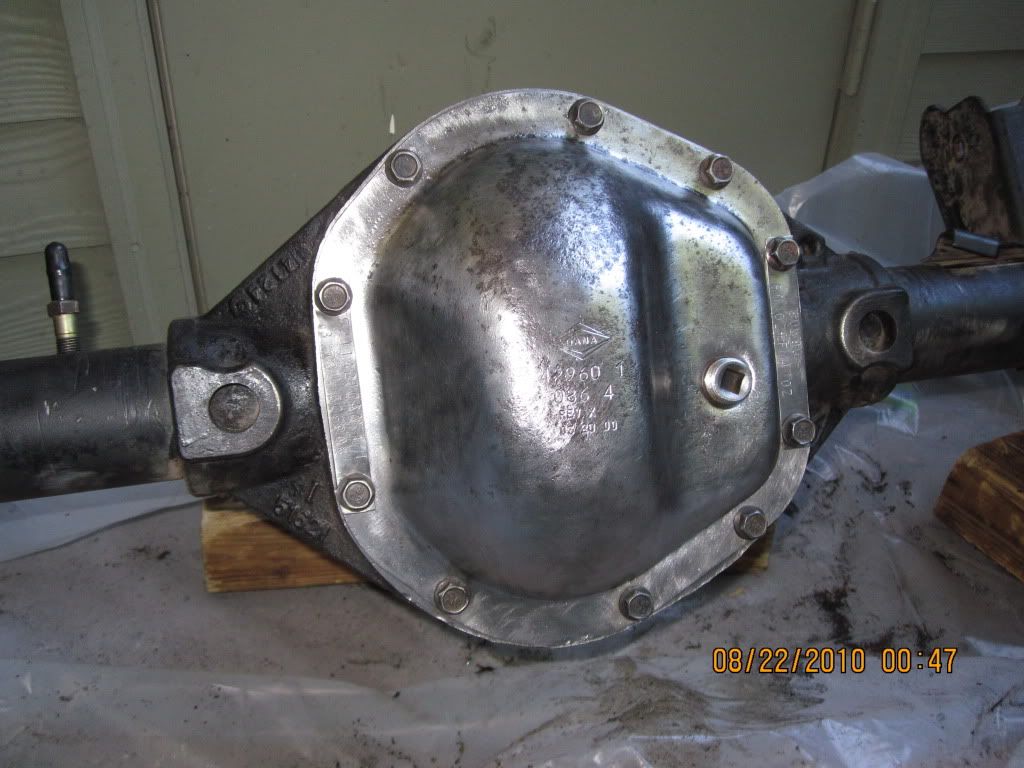

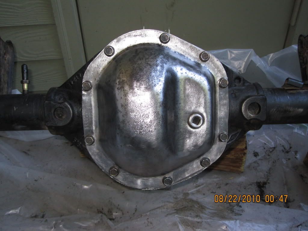

update: I worked on the diff cover some more. I'm probably done with it. These little dirty spots you can see are imbedded into divots in the metal. I just don't have the time to waist on it anymore. Time to move onto the axle.
tcoche is offline
post #24 of 144 Old 08-22-2010, 03:37 PM
freeskier93
Location: Highlands Ranch
Posts: 7,297
Looks good, I would hit the cover with some rust neutralizer, like Ospho, before you paint.

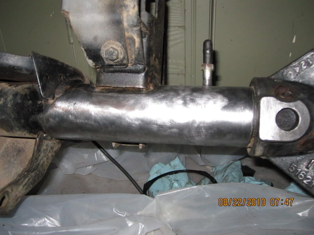

worked on her for about 35 minutes this evening. I have a feeling this is gonna be a long process. I have a baby daughter so it makes it a little harder.
How is everyone else wire brushing? Are you using those little wheels for the drill or is there some magical brush that makes this ***** go quicker?? Can you please recommend a certain product, method or something!
Here is the little bit I got done tonight. I cleaned the diff cover where the sealant goes with the wire brush. I also cleaned the same area on the diff housing area. Come out beautiful! I also started wire brushin down the axle tube....(the yellow that is reflecting on the newly exposed metal is from the cardboard i'm sitting on)
tcoche is offline
post #26 of 144 Old 08-23-2010, 01:34 AM
PistolPete99
Location: Titletown
Posts: 71
i use a angle grinder with a wire wheel attatchment works like butter
4 inch RC, 33s, 4.56, d30 front aussie locker, F8.8 Detroit, AA sye complete with a woody :), warn sliders
PistolPete99 is offline
