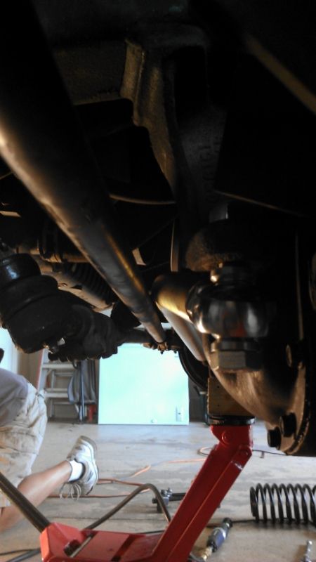

Installed...
It clearly hits the tierod just a little bit and I didn't get any full bumps pics because I didn't want to take the coils out. Lazy I know, I know. Keep in mind I don't have BS extensions yet. The install went really smooth but I didn't put a washer on the frame end side. I suppose I should do that...
Are you going to add BS extensions to clear the tie rod? If you do, could you post a pic afterwards? Thanks!

Eventually. I've had 2" extensions laying around for months, I just never get around to it.
I'm actually surprised it hits but I guess everything can't be perfect.

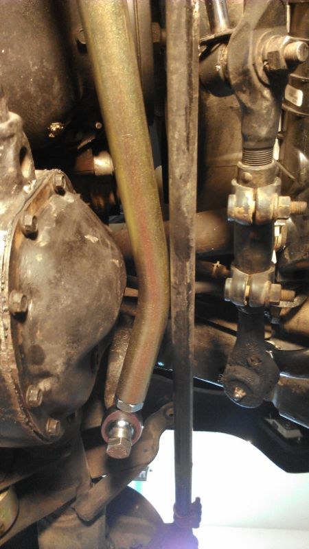

I got the chance to play with a MC front track bar: 16.25" LCA's, ~15" UCA's, clears at stock full bump.
Barely clears the stock tie-rod:
It does clear the stock diff cover at full bump.

Well I guess we know the minimum amount of bump stop for the MC bar. I am guessing at steering lock you would have some serious contact on that tie rod.
a V8 ZJ tie-rod would fix that....not that you see full lock at full bump much...
more importantly, a little bumpstop extension would be required for a larger OD tie-rod like the Currie stuff....and all bets are off with a tie-rod flip.

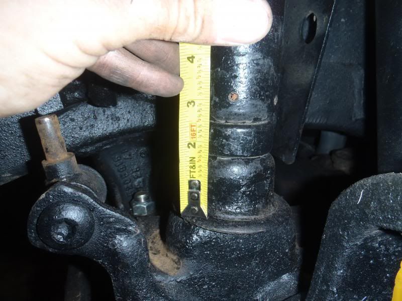

Would that be enough extension in your opinion? About 3/4" if I can read my crap picture right. Steering is on my radar thinking currie once I have enough saved up.
so far i've been quite pleased with the MC bar.
Having both sides at full bump and being at full lock would be a pretty rare scenario. You'd probably want to check though having the drivers side at full bump and passenger side drooped at full lock, that would be a more likely scenario. But because the passenger side is drooped the bend is going to rotate down underneath the tie rod and likely not be an issue.
My point was just that steering input changes that relationship. There are many many combinations to consider some rarer than others.
