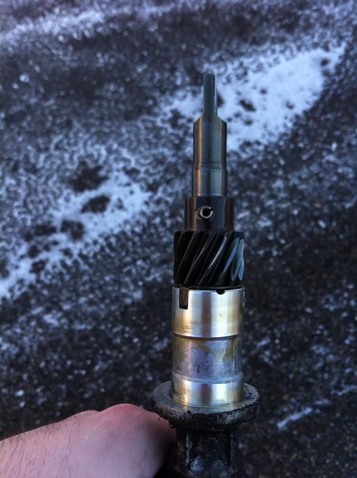

2005 aus tj 89000km ~ 55000 miles bought brand new.
2. Brief description of the problem and any collateral damage. Please include pictures if available.
paranoid from new read TSB - read on this forum,
recently noticed maybe slight squeal, kinda like timing chain lash, mainly when hot and particularly on declaration.
pulled unit pics attached.
scorching, abnormal wear on odpa gear and cam gear.
- is wear on the square tip of shaft that slots into oil pump drive normal or part of this ?

sorry about dodgy cam drive shot it was...
