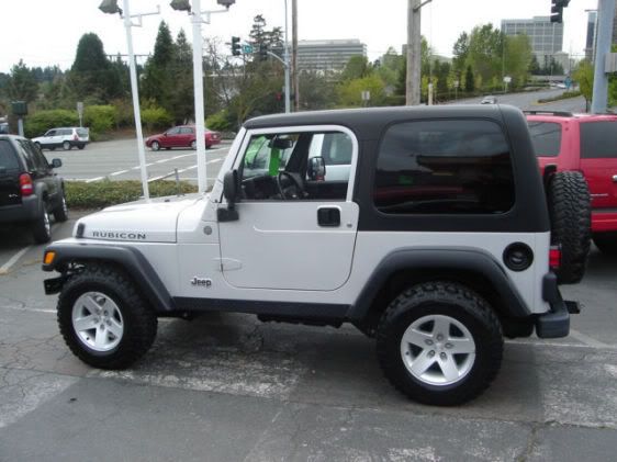

I just installed my OME ZJ/LJ combo, + JKS 1.25" BL, JKS Quicker Discos, JKS BMML, JKS adj rear trackbar and got some new 285/75/16 MTRs.
Measurements taken at front and rear rocker before and after on metric 31s after driving for 60 miles:
Before F/R: 18.0" / 19.0"
After w/BL F/R: 22 3/16" / 22 14/16"
Suspension lift gain(not incuding 1.25" BL):
F/R: 2 15/16" / 2 10/16"
Stock:
Lift and 33s:
I know the pics are not the best for before and after angles. The lift rides very well, the nose seems a lot more stable now, than with the stock suspension and winch. I have a warn M8000 on the front bumper and a Bestop OS tire carrier with a spare 285/75/16 on the rear gate. I deffinitly would not suggest this spring combo for those not running extra weight.
