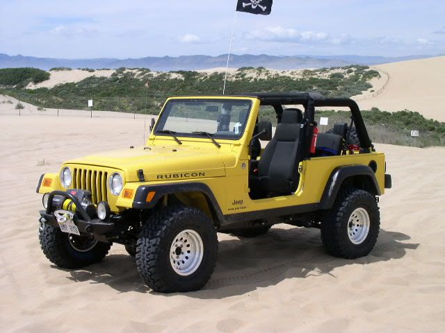

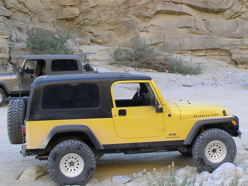

A picture is worth a thousand words.
OME/DPG Ultimate HD springs with 3/4" spacers. JKS 1.25 BL.
