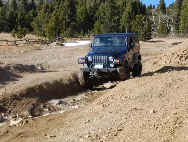

OME 2.5" + 1.25" BL here...works good for me:
