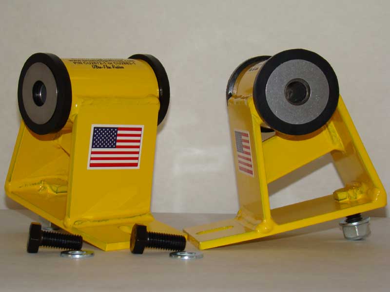

will this eliminate my need for t-case spacers on the OME?
CU2883-1 Jeep TJ & LJ 1" MML, Ultra-Flex Rubber

Posts: 1,458
they are rubber too and not poly!!!!!!!!!!

Posts: 22
If they will lift your engine up an inch, they should.
