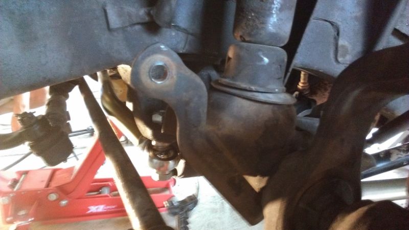

So .. I took a pic of the stock tracbar and I see the rough country doesn't have a good bend in it as the stock bar does.. when you suggest that I leave my stock bars alone .. are you suggesting that I just leave my axles off center? it is mostly aesthetic that i want to change them.. However, I am kinda lost.. I have read a good majority of the threads . Included is a pic of stock and see a very big difference between the one I orderd.. which seems that it would rub.. compared to my stock ..

Originally Posted by TJSIDNEY View Post
I am not sure what kinda of wheeling you guys are thinking I am up too.
i'm just trying to help you get your jeep working for the street. we haven't even starting talking about wheeling yet.
you keep hitting stuff when you hit bumps and something eventually has to give...the weak tie-rod end used in the cheapo track bar.
then you get to experience the loss of steering. maybe on a speed bump, maybe after a pothole, maybe even on the highway at 70.
Originally Posted by tsa1980 View Post
I got the rough country front adjustable one with the bracket for better clearance.
oh, you mean the bracket that sits directly over the tie-rod and uses the tie-rod as a bumpstop:
^that's sitting on flat ground too...not flexed or anything. those brackets doesn't even work with 6" of lift, let alone 2".
Example
only way to show your stuff works is push the axle full bump. support the frame, remove the springs and jounce bumper, use the floor jack and push up until something hits.
this is full bump, and yes your suspension will travel this far up.
