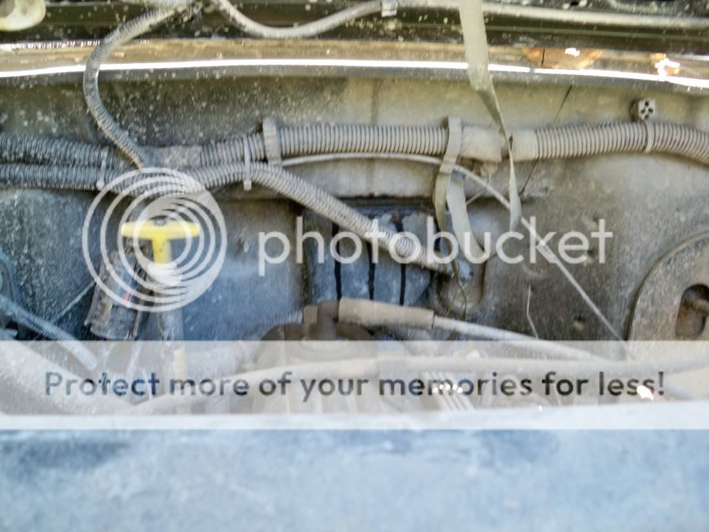

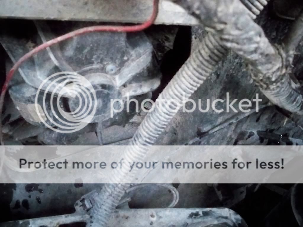

In response to a massive leak under my passengerside dash i was told to take out my battery and clean the "cowl drain" i have taken the battery out and did not see a drain. I have enclosed pictures, mabey i was looking at it without knowing what it was. In the center of my engine towards the back, there is a plastic tube thing (see pictures) that leaks because a seal is shot (also in pictures) i pulled about 5oz of dirt out of that. is that the cowl drain? if not, what is it? Any step by step pictures about how to clean a cowl drain will be very greatly appeaciated.

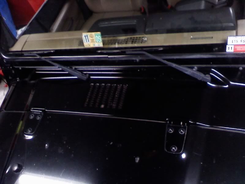

you have to pull off the cowl first, its got a few screws in it, i think 2 under the rubber seal between the cowl and the hood and then 5 or so on top of the cowl. 1 in the opening and 2 close to the wipers and a few across the top of the cowl. pull the wipers off, pull out the screws then pull out the cowl. look for a lot of crap all under that panel that you just pulled out. remove crap and flush it with water.
this is the cowl--not my pic btw and it is not the same design as our cowls, so just use it for reference of what a cowl is, its the whole panel there.

theres a better pic of the cowl and it is mine. there are 5, possibly 6 screws on the top and i think only 2 under the rubber piece

There's a slim chance that it's leaking from there.I'd remove the hood cowl and clean the drain and seal around the air vent on the passengers side(under the cowl).I always use silicone to seal it.Here's some pics on how to remove it.

That piece in the middle would be the cowl drain. Mine was completely plugged, and after i cleaned it out, i didn't have that same problem anymore. Another place i have leaked is when the ac drain was draining back into the jeep, but that only happens when the ac is on.
