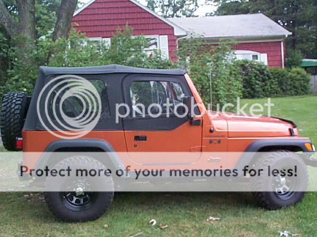

I just did a bunch of mods over the past month. Here is the list:
Rubicon Express Budget Boost
Springs from a Rubicon (ebay-dirt cheap, only 500 miles on them)

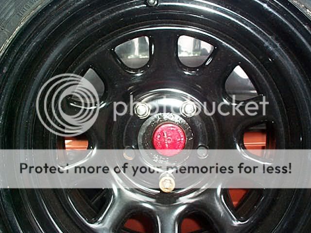

5-Cragar 342, black steel wheels, 15x8 4" backspace
Warn Rear Bumper & tire Carrier. (the wife surprised me for
my B-day. I was really surprised considering how much
she hates the amount of time I spend with the Jeep)
Jeeperman third brake light. (just to stay legal in NY)
Jeepit.com mirror brackets
Skid Row engine skid plate
Cobra 75wx st CB
Firestik II antenna
Bestop Duster
Bestop Bikini
Recovery-shackles, tow strap
Set of tools for the trail
Here are some pics. Going wheeling in 2 weeks, will post some flexin pics soon after.

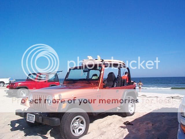

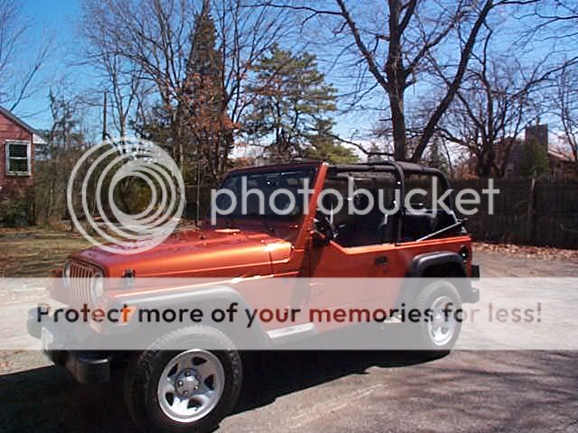

Day 1 only 11 miles on it
1st summer with the Jeep at the beach
A few weeks ago before the lift but with the wheels

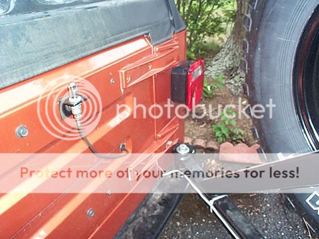

The Jeeperman 3rd brake light kit is an easy install. You need to buy black silicon. What I did was drilled a half inch hole in the part that holds the tire on to the carrier. Then I used my Dremel to cut the hole to size. It is oblong almost like a capsule shape. Then I drilled a hole on the backside of the carrier and ran the wire down the tube and under the jeep. You need to pull the black plastic wheel well on the passenger side to run the wires inside to connect them to the 3rd brake light wires. When you open your tailgate you will see 2 contacts on the side, they are silver and are about the size of a dime. The wire connects to them from the other side in the wheel well. Very easy to do. Now I have the CB antenna run through he original brake light hole in the tailgate. The black silicon holds the light in place.
Here is a close up of the light in the tire.
Here is the back where the wire comes through
Here is where it goes under the jeep into the wheelwell and also the cb antenna mount.
