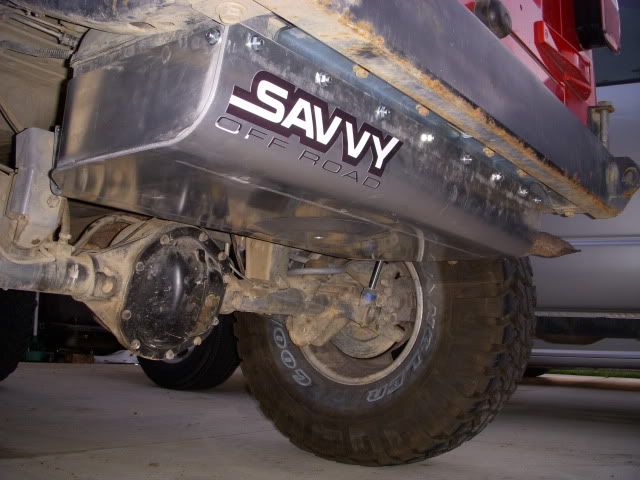

Seeing as Jerry is a well respected member of this forum and a personal friend who wheels on difficult stuff, he was kind enough to beta test one of these for us and give some needed feedback.
We've also asked robncar to do some testing as well and look forward to his reactions.
yeah i understood that, but i was just curious as to how well a steel gas tank skid held up to rough wheeling after 11 years
and just so you know, id be glad to be your guinea pig for beta testing new stuff
Not bad, dent and gouge/scrape-wise, but it's a PITA after most wheeling trips to have to wire brush it and re-paint it to keep the rust at bay. So in addition to no more rust worries, the new aluminum skidplate's reduced weight will be nice because my TJ is getting up there weight-wise.
Steel holds up well. It always has, but it comes with some penalties including expense and weight and continued maintenance.

Just because 6061 doesn't rust, it will still corrode. I would still recommend a coat of paint on an aluminum piece of structure. At least some alodine if you can get it, just don't leave the bare metal. As for 6061, we use it a lot and it is a very well behaved aluminum, even in space. Also easily repairable. As for making the corners blaine, I would recommend forming the primary structure and then doing the heat treat, if you can. I know Alcan will sell you material in the T-0 temper.
nice idea, i cringe every time i add more steel to my jeep.
edited for spelling
I'm well aware of the -0 temper and seriously considered it, but I don't have a good local heat treater that can bring it up to the -6 temper when I'm finished with the forming.
Since I need two separate parts to make the design work, I would only save a few pounds by making the mounts in aluminum and then the costs would go up because laser cutting aluminum is not accurate, much slower, requires much more clean-up and then I have to get the heat treating done.
The design is a pretty good blend of materials and their usage in the right areas.
But, it's nice to find someone who understands aluminum enough to know what -0 temper is.
