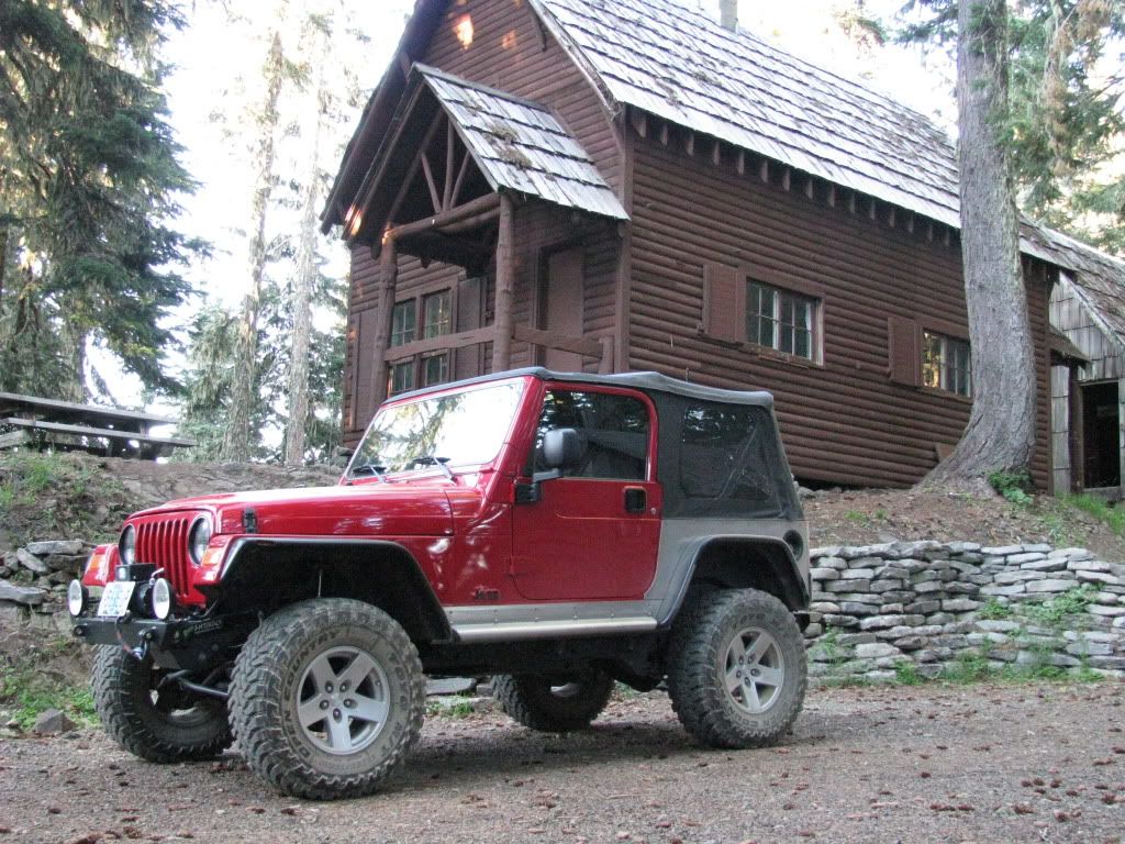

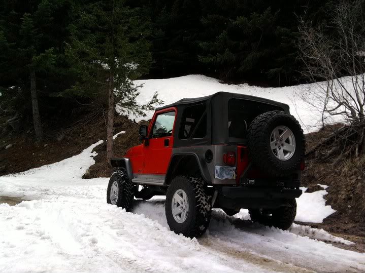

I ran 285/75 16 tires on Rubicon Moab rims which are 16x8 with 5'' of BS. It's very close. If you have stock lower arms, or your front axle is not centered with an adjustable track bar you will rub at full turn.
