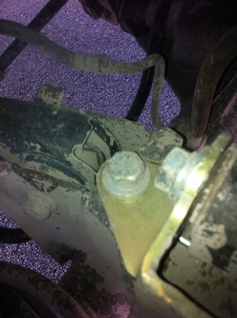

She's a little dirty underneath but...
From passenger side looking across at it
From Drivers side just inside the front side of the tire
Directly on top
Here you can see that there is about a 1/8-1/4 gap where that hole is
and lastly from underneath :

Thanks for the pictures. They are helpful. I don't see the gap on yours that I could see on mine. I think yours fits better than mine will. But I'll give it a shot and see how it looks when its done. I just hope the gap I have doesn't allow it to loosen up and wallow out any holes.

Yeah, those scratches in the last pic are from a pipe wrench to finish turning the torx... I hate torx. But if I remember correctly there was a slight gap, less than the width of a quarter, and we just tightened it up until it bent into shape with the stock mount. I don't remember an overwhelming gap though.

I went out and started putting things together today and it looks like there is more freeplay between the bolts than I expected so the bracket should snug up pretty decent. I noticed you used the factory bolt in the lower hole and the directions say to use the factory bolt with the track bar in the OME mount. I wonder if it makes a difference? I think I'll probably do it like you did and put the factory bolt in the lower hole since the nut has that wing on it to hold it in places as I tighten it down.

You can see in the last picture I posted the hoses go over. I have a 1.25" BL so guess it wasn't as tight a squeeze.
