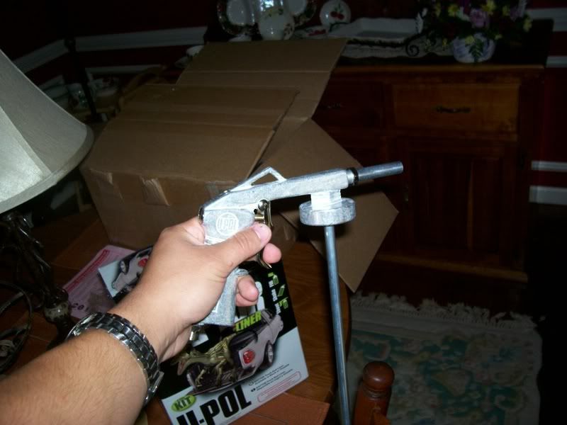

So I'm -planning- on lining my Jeep's tub this weekend with U-Pol Raptor. I chose this stuff since it comes with a spray gun, isn't soft like Herculiner, is relatively cheap($100 for the kit), and I REALLY like the results I saw from some other JF members with this stuff. I'm hoping to do all the prep work this Saturday, possibly start spraying Saturday night, and finish it all up Sunday. Then I gotta drive it to work on Monday.
It's got the spray gun, the 4 bottles of stuff, a can of the hardener to activate it, and instructions. I need to go out and buy tons of masking tape and plastic crap to cover things.

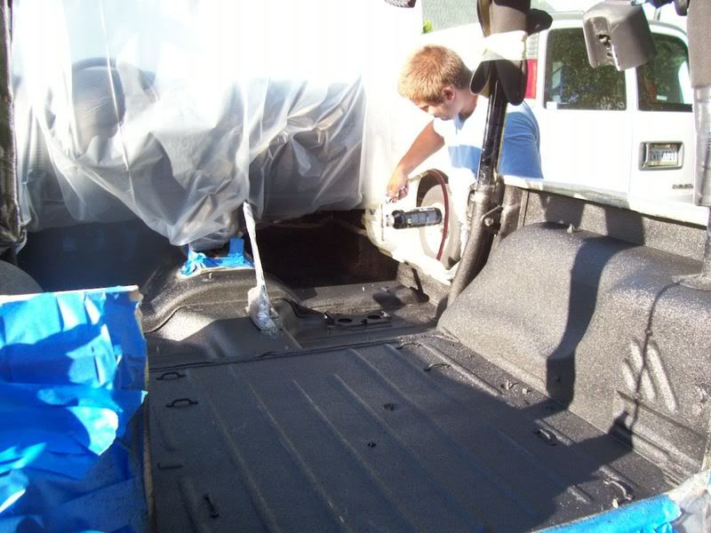

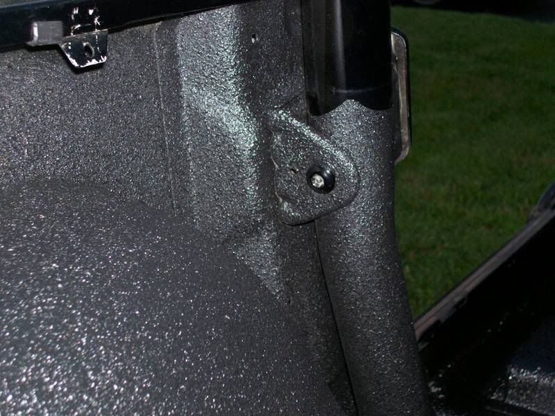

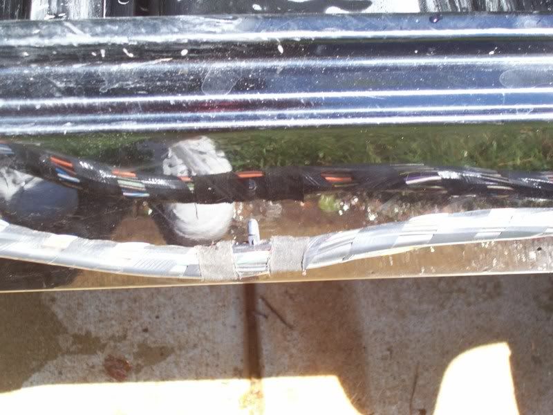

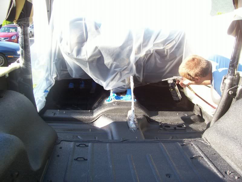

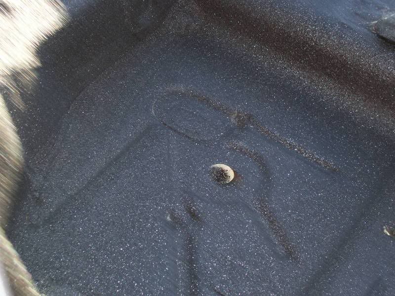

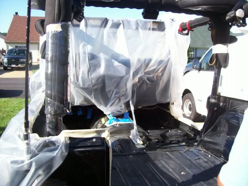

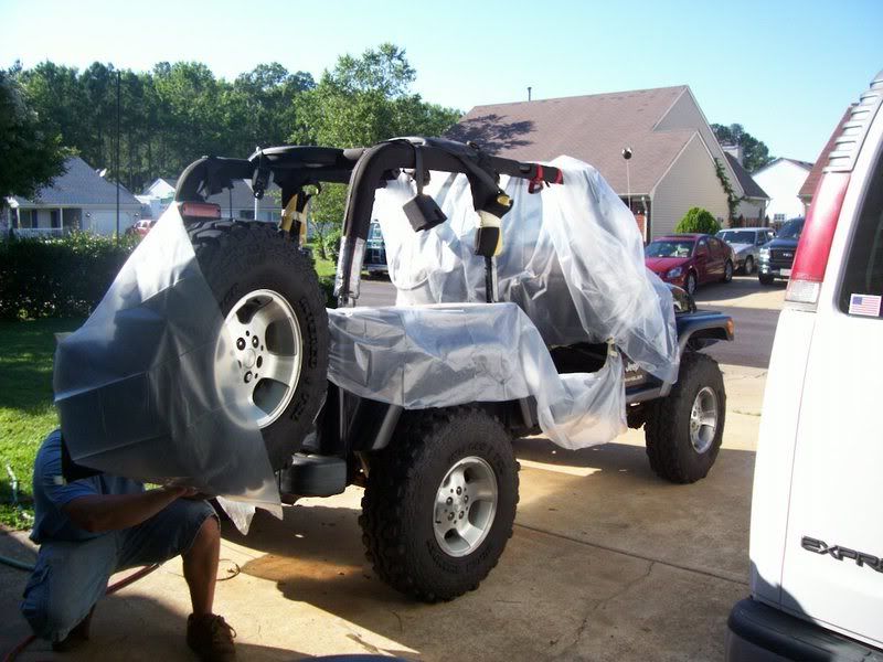

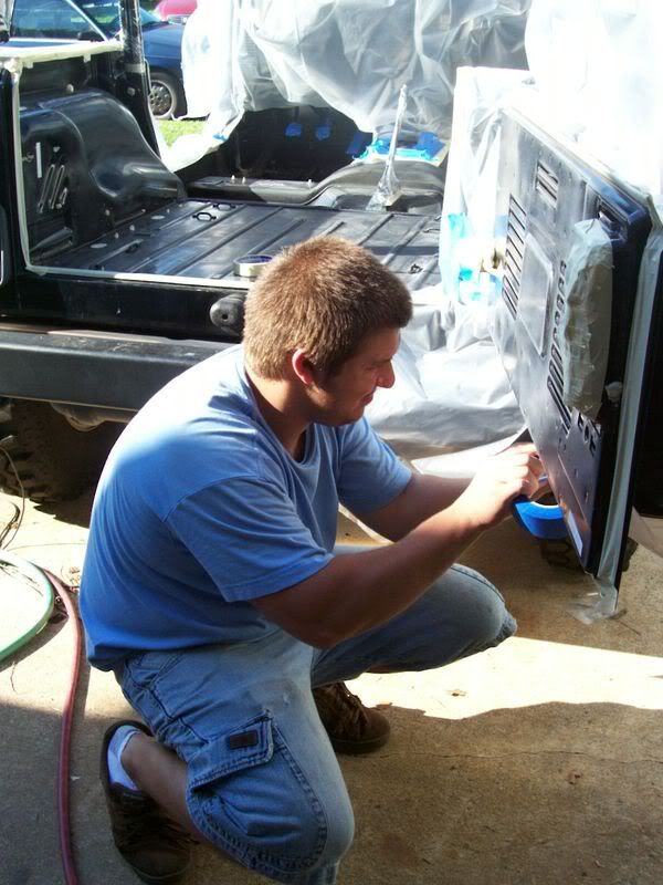

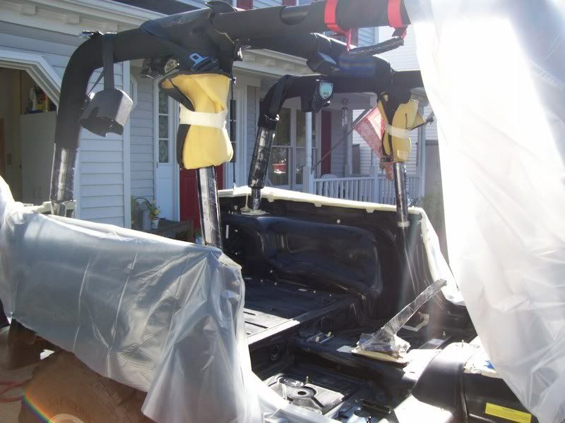

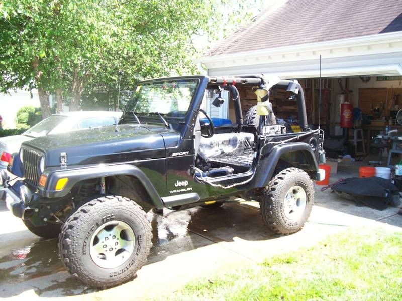

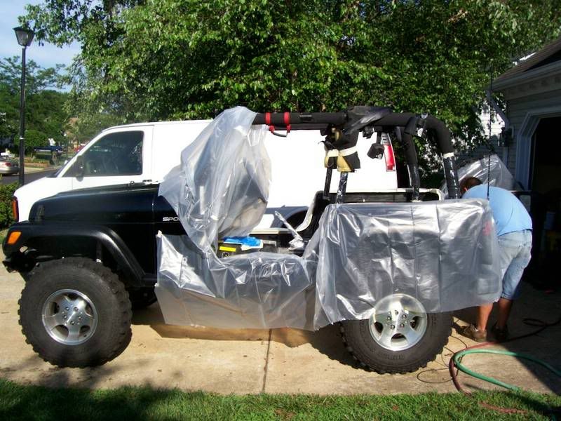

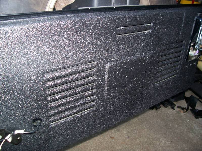

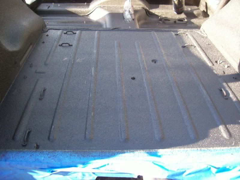

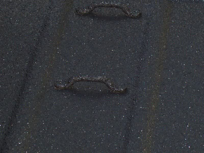

Well I got everything done and sprayed in a time of about 11 hours including a lunch break and clean-up. Haven't put the stuff back in yet, gonna do that tomorrow afternoon.
Got up at 9:00 or so and got started around 9:30.
Started by pulling the seats, seat belts, center console, all the little doo-dads in the tub, all bolts I could see, all the latch hardware on the tub, etc etc.
I was about to pull the cage and found that the factory was kind enough to put seam-sealer on every one of my cage bolts on the floor, and I was lacking a T-45 security torx so I dismissed the idea of pulling the cage for bedlining. Also decided to not go above the rail, no particular reason, I can do it at another time if I decide to do so. I was thinking about just brushing it on there in the future.
My fiance, Shaynea came over at about 10:15 or so to help me out. She was very helpful in sanding and masking stuff off.
Basically the steps I took was:
1. Strip the tub of anything and everything
2. Vacuum it all out
3. Wash with soapy water and rinse out well
4. Sand the tub to scuff all the paint where it would be covered
5. Rinse out with water then dry it off as good as possible
6. Dowse a rag with mineral spirits and wipe everything down really well
7. Mask what couldn't be removed and what shouldn't be lined, and fill the bolt holes with balls of tape
8. Wipe down with mineral spirits one last time
9. Shoot the bedliner according to instructions
Here are the pictures
(The little yellow sticker is funny, it says the carpet is there for insulation and driving without it could cause burns to feet haha)
