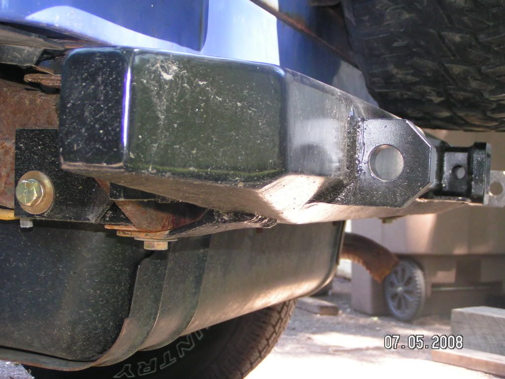

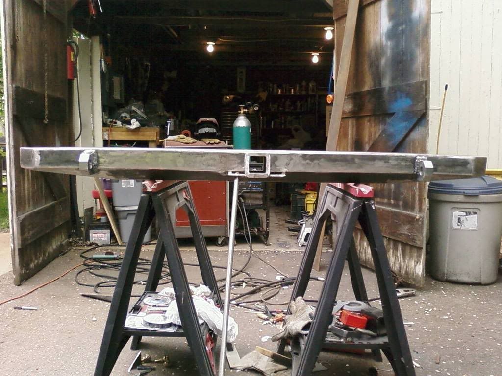

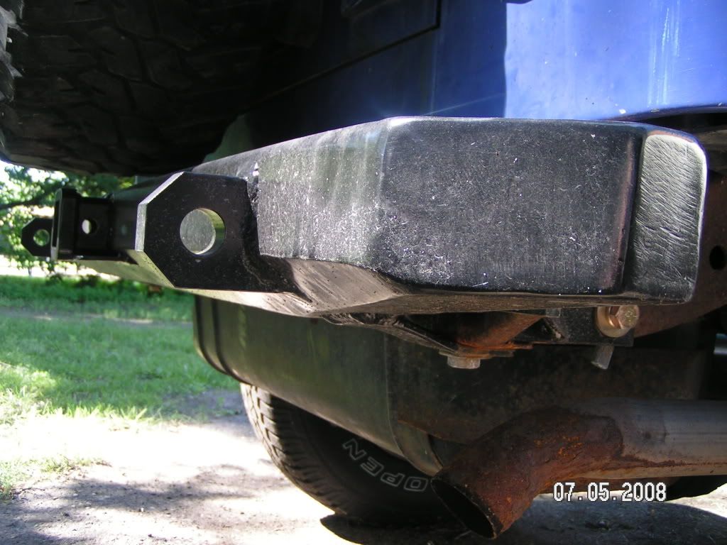

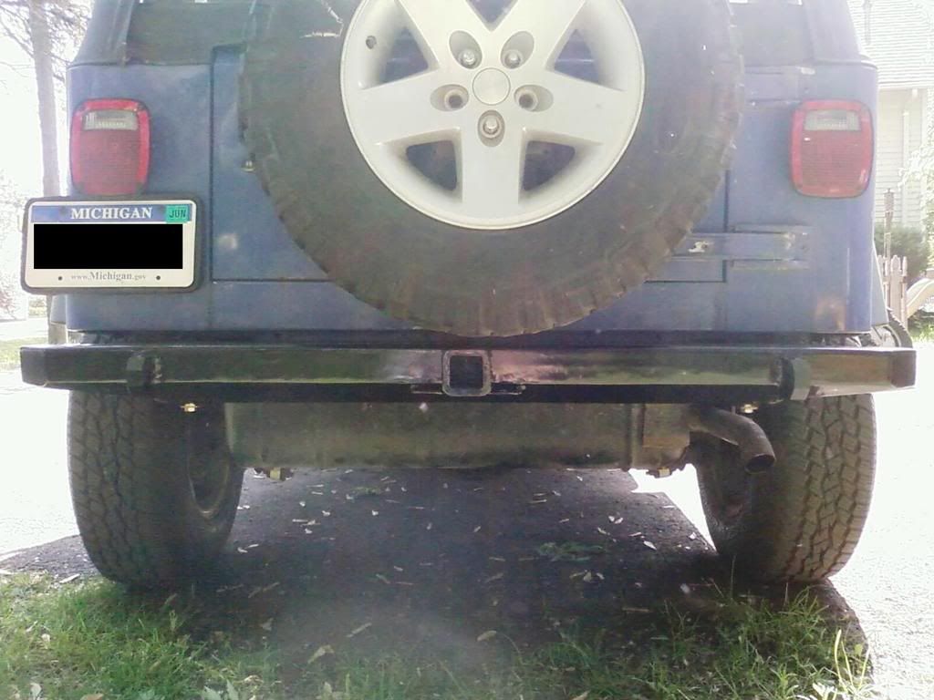

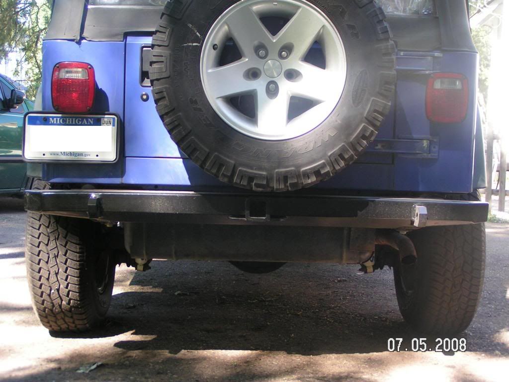

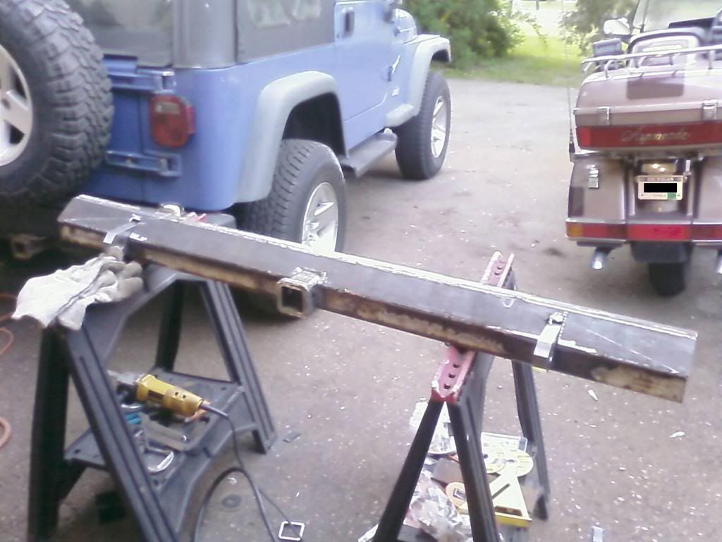

I'm finally getting around to posting these. I built this a couple of months ago. I will be adding a tire carrier to it in the future.
It started out as 4"x4" 1/4" wall square tube.
Sorry about the lousy cell phone pics, but they are all I have.

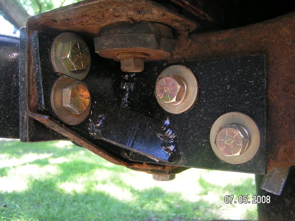

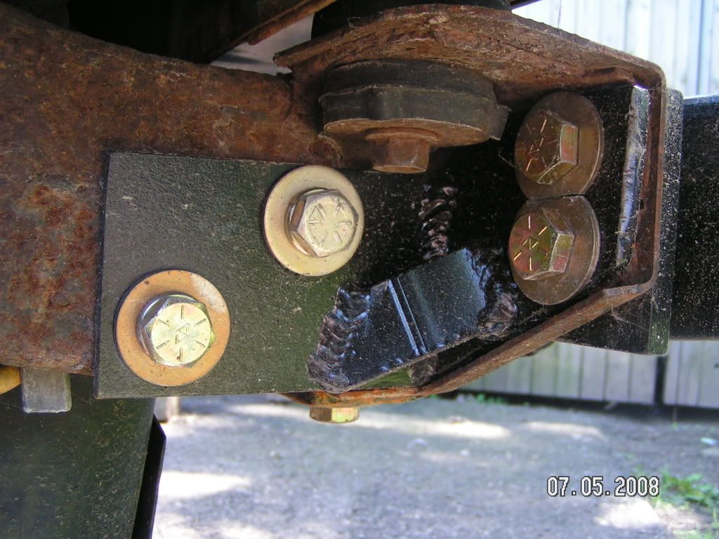

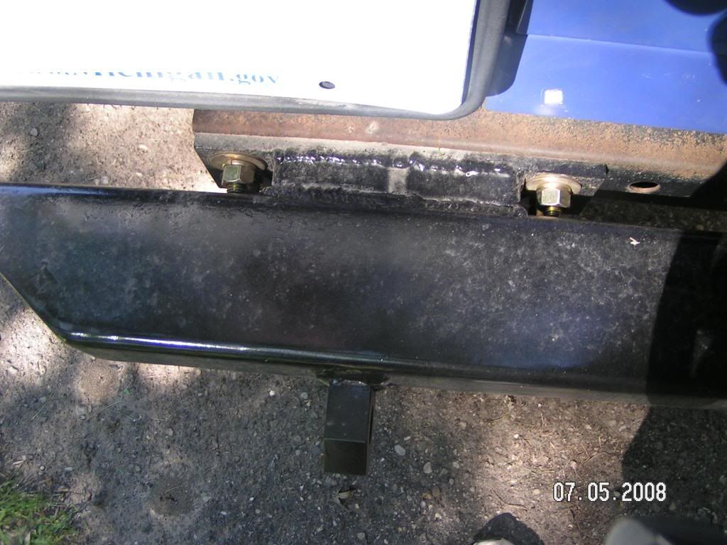

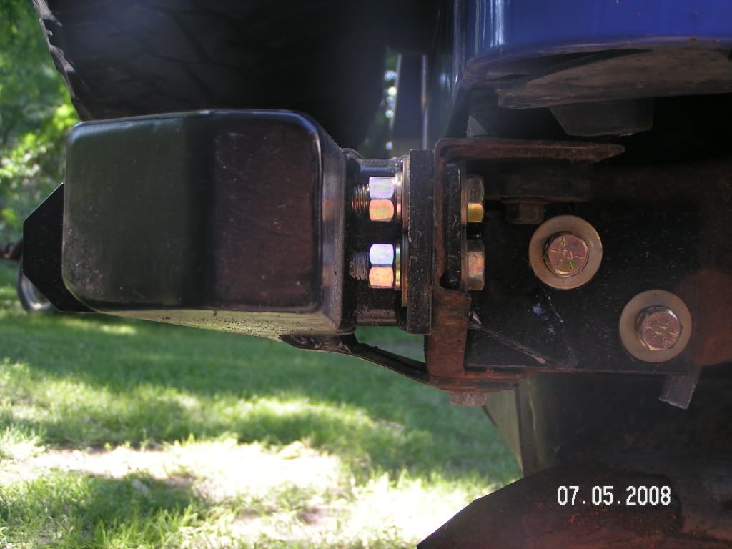

I just took some more pics, including my frame tie-in's, I made at the same time. Sorry it's dirty right now.
Mounts:
Tie in's:

Thank you. As for the mounts I wanted to make sure it was solidly attached to the frame, since I removed the reciever hitch I had on it before, and this will be used for towing and recovery. I would hate to have someone winching my Jeep out from the back, and end up with only the bumper pulled out of the mud.
The nice thing about this project was that it was all built out of scrap that I had laying around, with the exception of the clevis mounting tabs.
