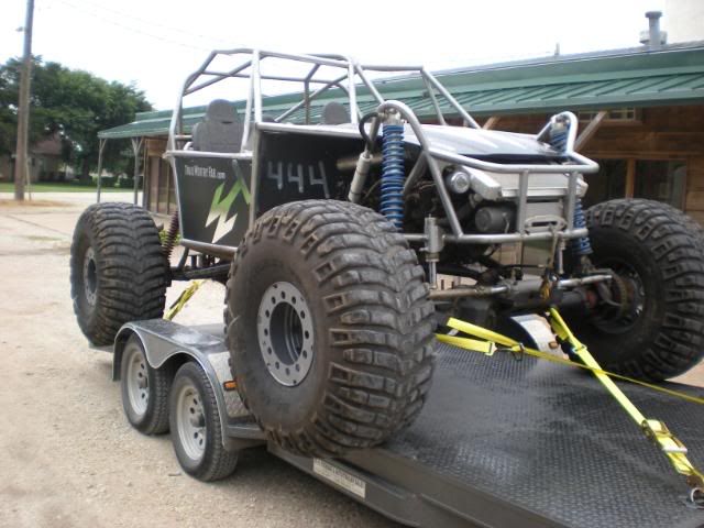

the pic above sums it up. You will notice that fords are not used in jeeps very often at all and for a reason. Unlike chevys the bellhousings on fords are different so for example. If you had a 350 chevy motor u could use a th350 trans, a th400 a 700r4, a 4l60e, a 4l80e get the point. And those are just the auto trans. the bellhousings match up to all of those where ford does not. I had a newer ford motor that I was going to put into a bronco trans and all. But when I got it and noticed how fricking huge the top end of the motor was and the amount of work I sold it. My vortec 8.1 was smaller than the smallblock ford motor as far as size. Bad choice imho to top it off then you have to try and find a transfercase that will work with that trans. all around a pain in the ***
BUY IT DONT' BUILD IT!! You will be money and time ahead. (Flip off)

FYI. Look for a 6 ltr with a 4l80e behind it. Torque monsters and they flat *** get it. That's what I run in my buggy and LOVE IT!! They can be had on the cheap. It's a V8. Sounds GREAT! The resale on your jeep with that in there would be huge. Go to Autoparts.com That site has every make of every vehicle you would ever want. You can find one with a trans mated to it in perfect running condition for around $1500. They are an LT1 motor. Injected. Aftermarket support is cheap.(unlike ford)
