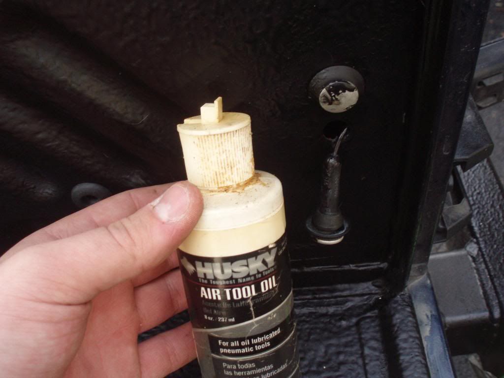

When putting the pins back in for the wires to the 3rd brake light, using a little bit of lube helps pop it in. I don't have pictures of the cover on the gate, but make sure the wire colors match. The top wire should be white, and the bottom one black, but it may be flipped, the specific position doesn't matter, it just matters that it is black to black, and white to white.

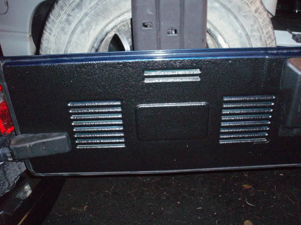

Just another picture showing the rear gate. You can clearly see the neat line left from the tape.

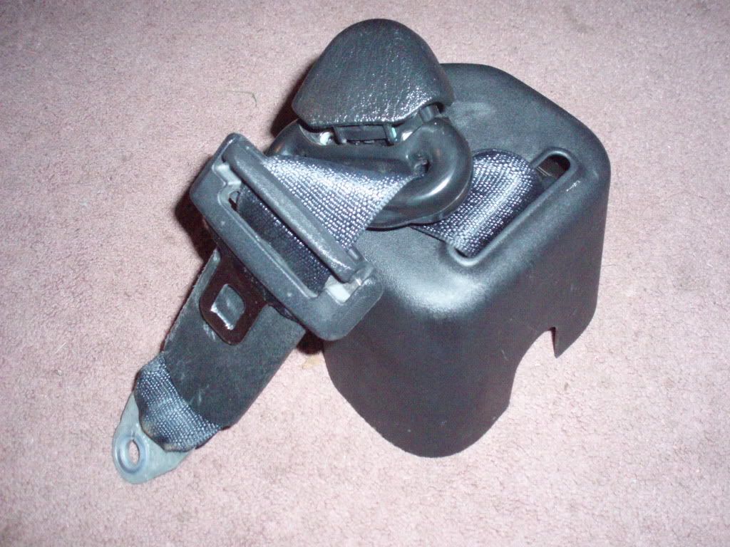

See how far in my dad got it stuck. UGH... I told him not to.
and this one

OK, that's not a problem, I had the same one. Hold the mechanism end in your hands while you step on the metal ends that bolt to the tub..shake (not vigorously but the seat belts work on a pendulum type system and when rocked back and forth they lock up so shake enough to unlock it) and pull up slowly..it'll take a lot of attempts but it works. You will have to hold them straight up and down just like they would be mounted in the Jeep
