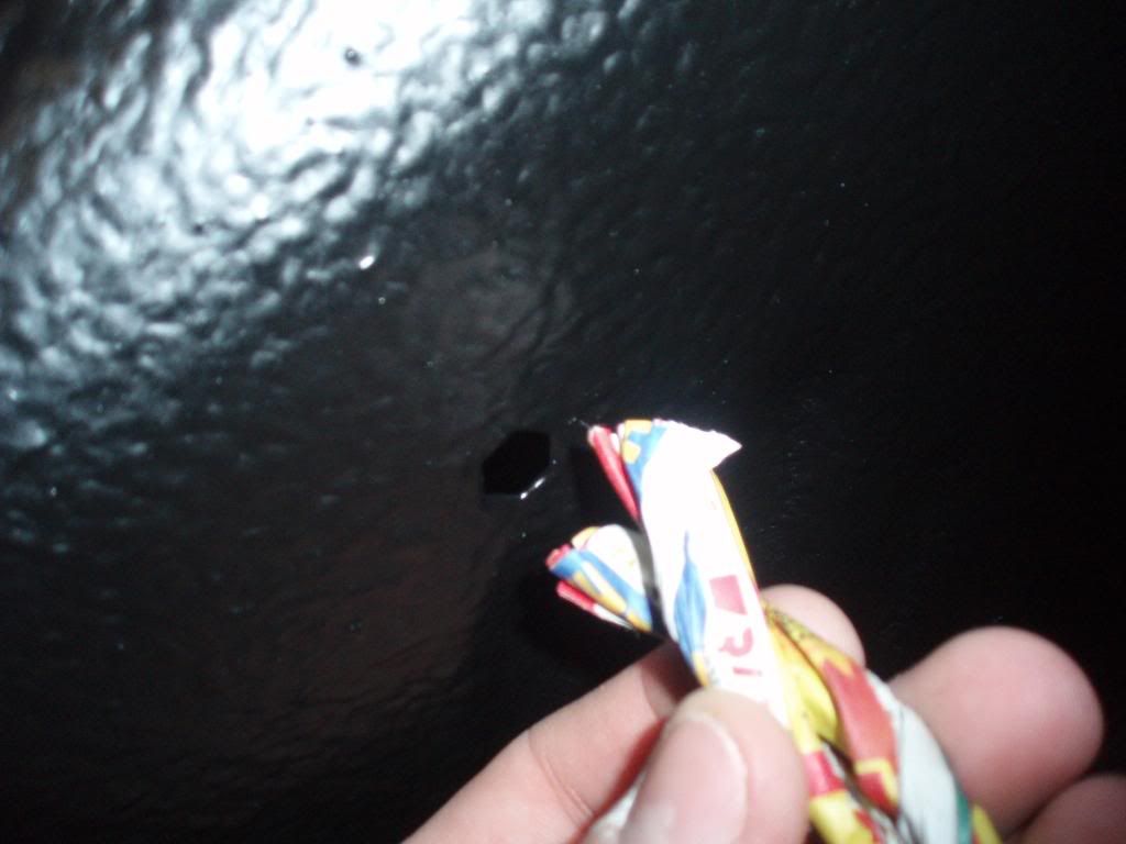

nice. If you a pics of the newspaper sticking out and how you did that, it would be awesome. I just remembered the local hardware store carriers corks of all different sizes for like $0.20 each...might be a good way to keep the stuff out of the threaded holes.

Ear plugs work great

Foam earplugs work really well as well.

Unlimited04, Both 99TJSahara, and Bennettj13 have good ideas with the foam ear plugs. I also think the cork is a good idea. My dad and I were just improvising. We took strips about 8 inches wide, and folded them in half until they were about 8"x12"ish and rollef them tight. Then folded them in half and stuck the two ends in the hole and screwed it in. I will get pics later.

Unlimited04 I took some pics of the paper for you. I will post one here, but You can see all by following the link back to my photobucket. I forgot to metnion, 1x 8"x12" will make 2 plugs. It is also actually ~5" strip, not 8".
The plug going in.

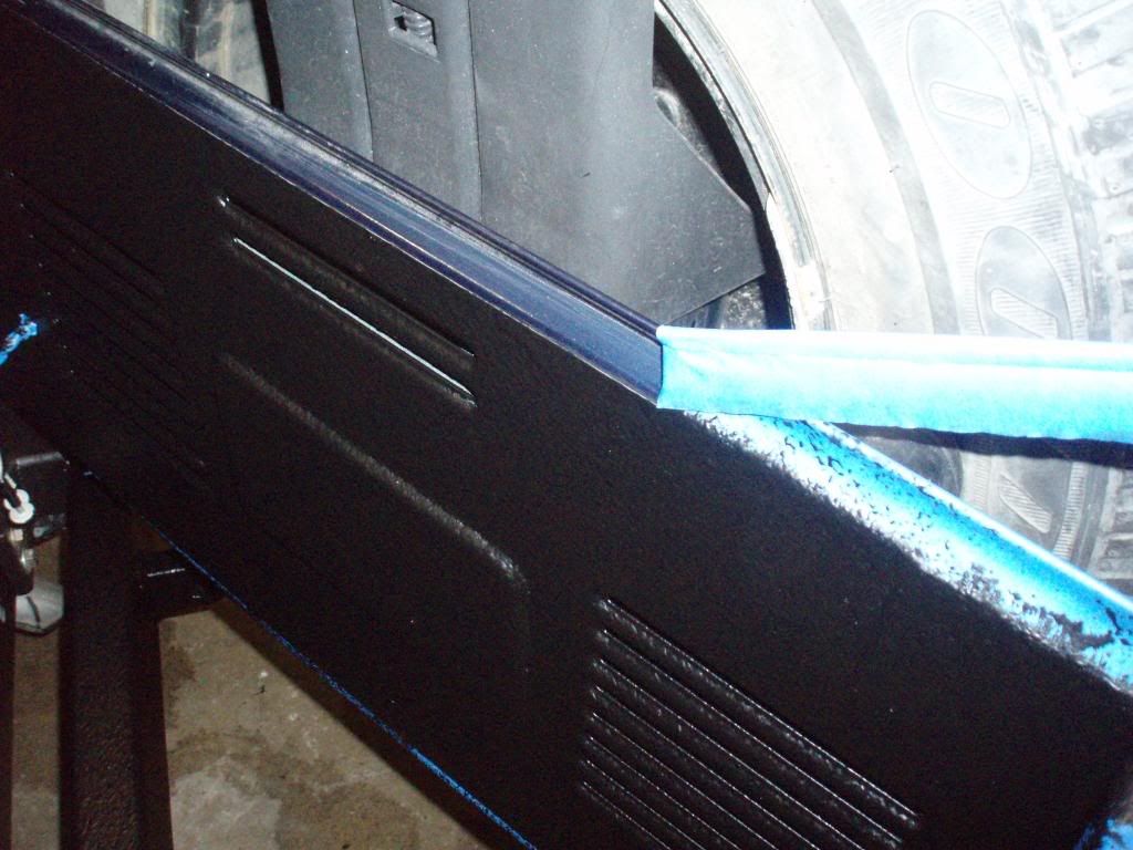

I was also asked earlier about the tape line. The site is right, it peels away nice and clean.
