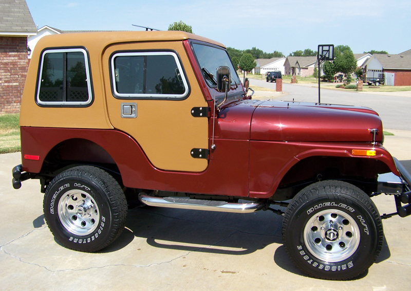

any examples of color monstaliner yet?????????
Here's a few

What color is that? It looks like it would match the camel interior in my Sahara.
1995 Jeep Spice

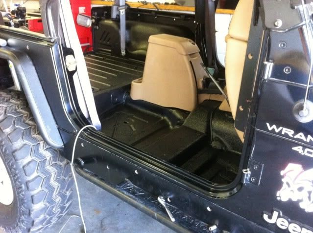

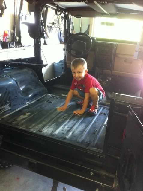

Did mine yesterday, very happy with results. This thread and all the comments sold me on this stuff, thanks.
Here's a few pix
Prep with my best friend

TJ-Bville is offline

Looks great, and I see your helper was put to good use.

Very nice texture. Glad you're happy with it
Here's a few pix
Next will be corner guards, fenders, bumpers
