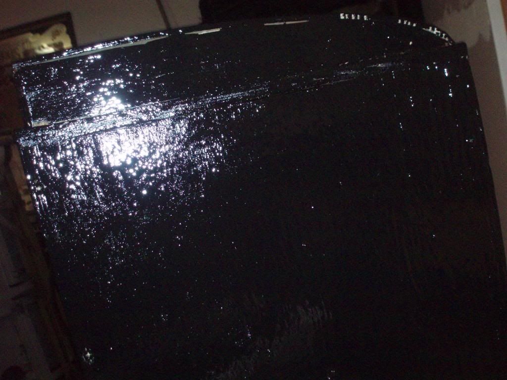

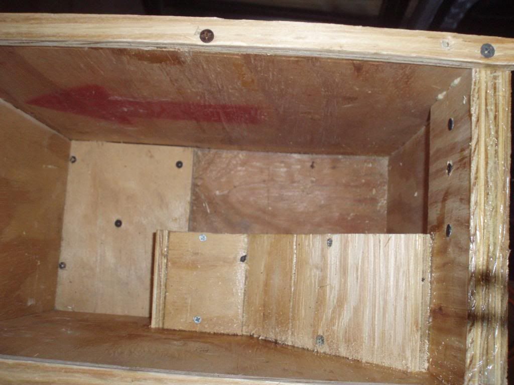

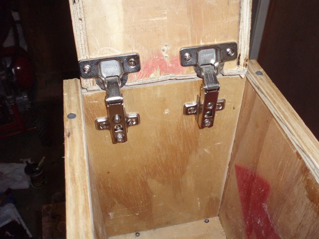

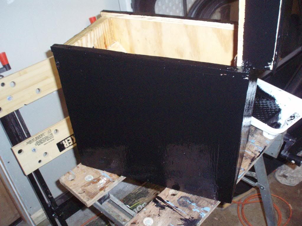

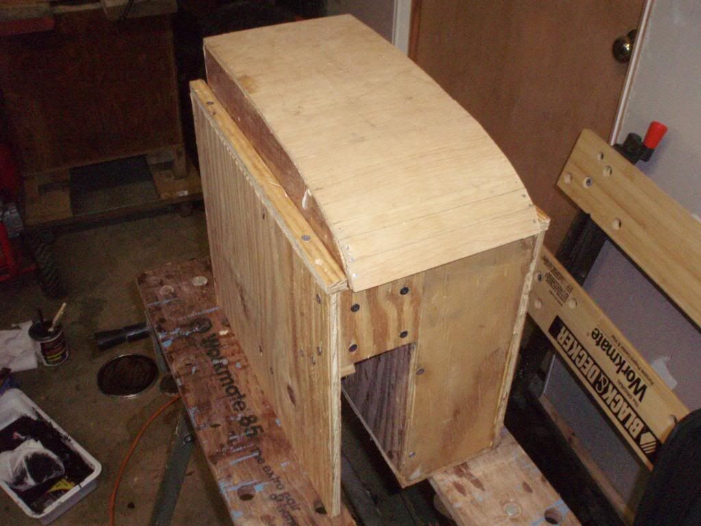

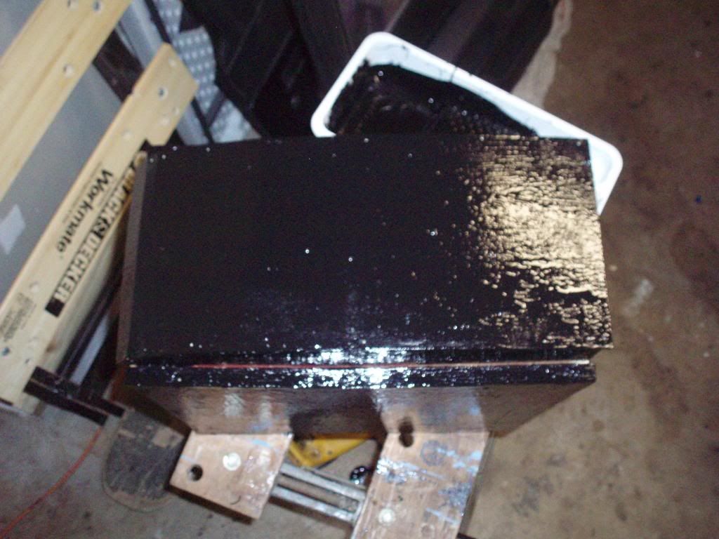

Here are the few pics I have. I made it, then ditched it for a real one
Yes, this is Liner on it:
I was very surprised at how smooth the liner was on it.
