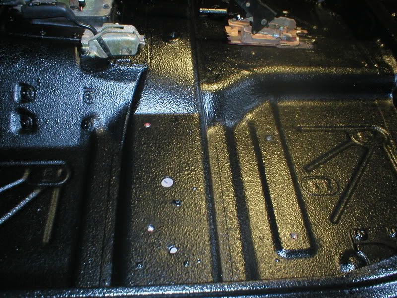

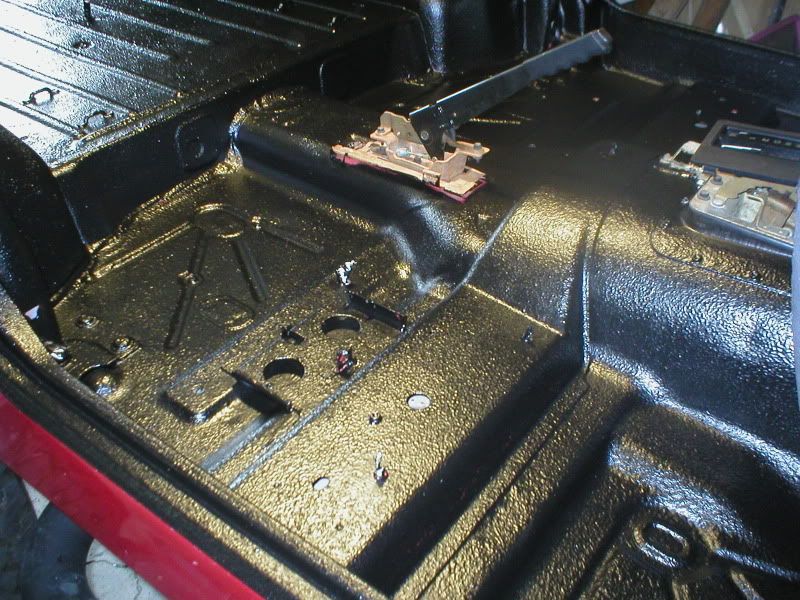

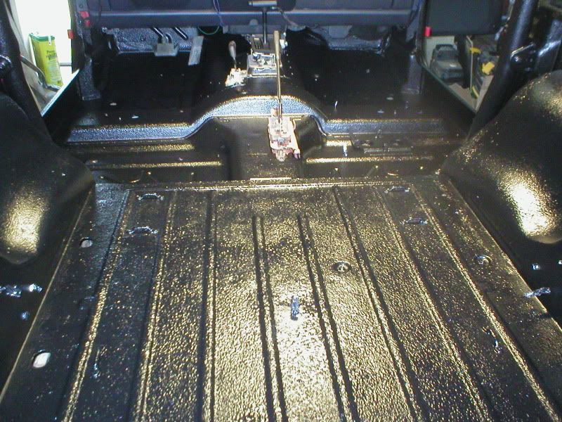

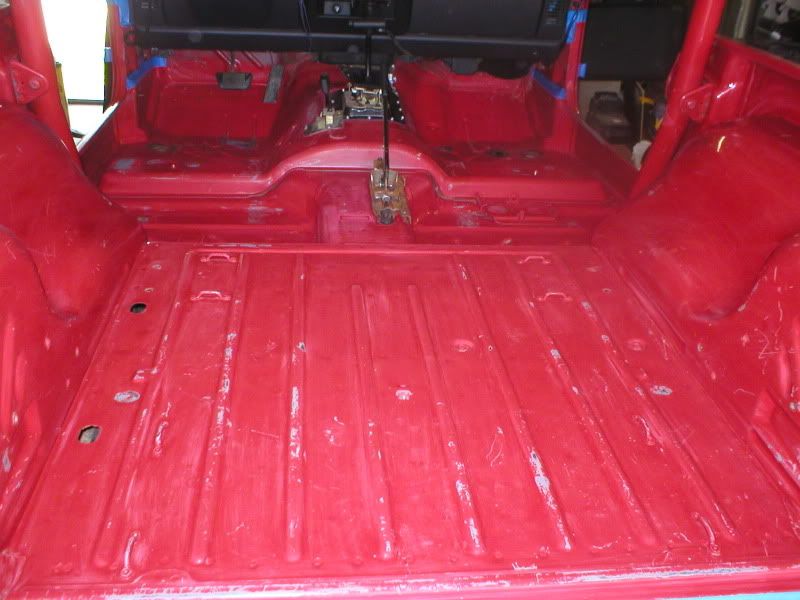

Finally got a weekend to get the jeep lined. Been slowly taking things out of the jeep little by little and friday finally took out the drivers seat. Cleaned and prepped everything on saturday, used chassis saver on 6 spots inside. Got an early start on sunday and got the first coat on in 2 hours. Went and watched some football and then went back out and put on the 2nd coat. Very happy with the results, no problems were encountered. I too made a small 2" roller, ended up using it over the bigger 4" roller.
Stripped and cleaned.
End results...
Thanks magnetman I am very pleased with the end results, very easy to do.

Nice job and great photos, thanks!
End results...
