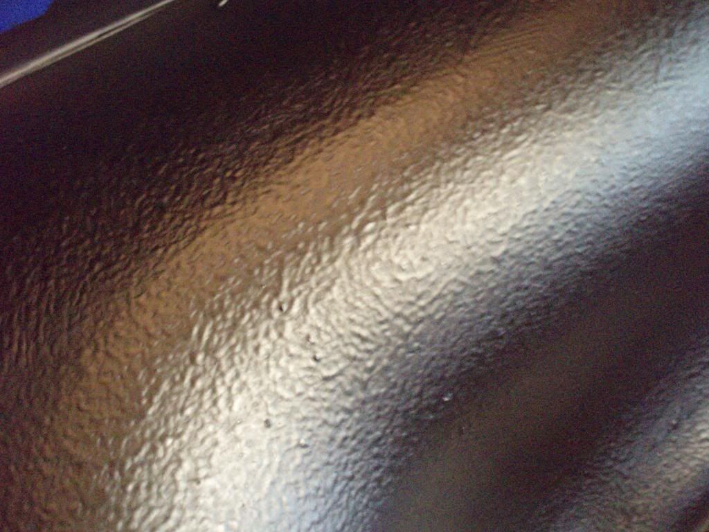

This is the texture shown on the fender well.

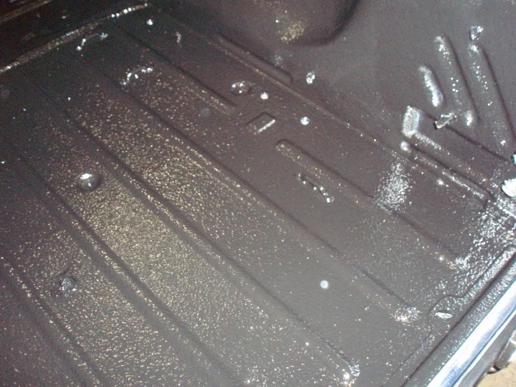

Last Image for a while. This is a shot of the rear tub wet.

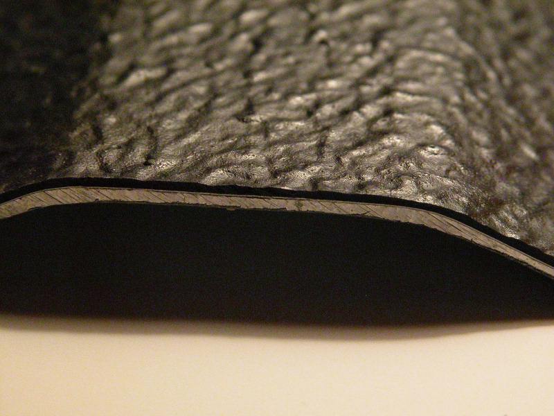

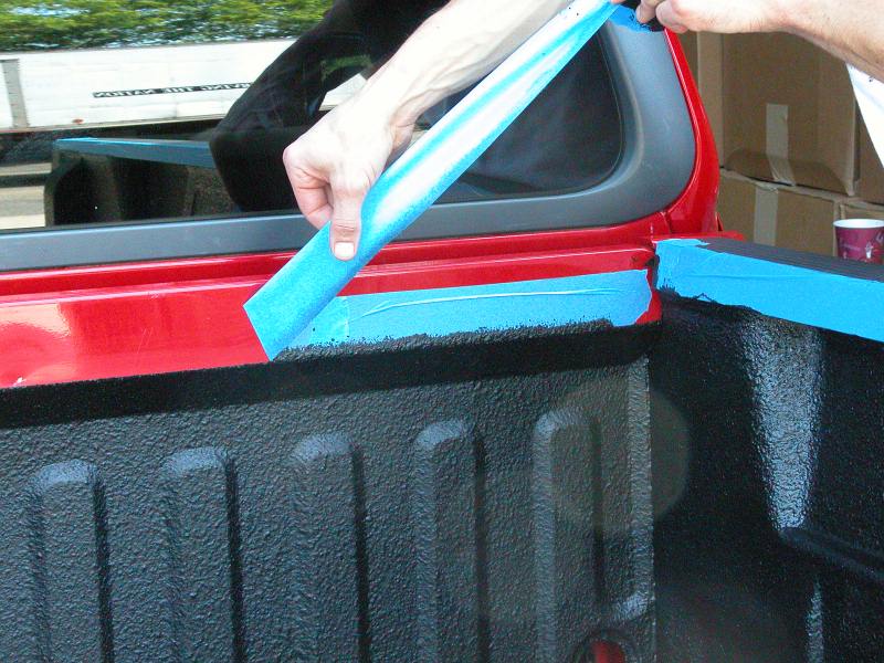

Man.. you are acting like I am done. It is in my garage drying right now. I haven't taken the tape off Yet... That is tomorrow morning when I got to spray it with some water. If you look at this pic here from their website, you can see that it Should come off clean. I will get some more pics tomorrow when I take mine off.
Edit: Here is a pic showing the thickness of the stuff. I believe this is 1/8" steel. That would make the thickness about 1/16" of an inch. The kit claims 40 mils which equals 1/25". I think they rolled it at about 1/16" thick for this pic, and I rolled it much thicker than that. I was not worried AT ALL about wasting the stuff. I still have 1 full gallon left over.
