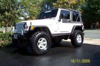

What size tires will you be running? A MML will allow you to NOT use the 1" t case drop that comes with the kit.You should install the lift WITHOUT the t case drop and see if you get any vibes.If you do, you can drop the t case 1/2" with washers or do a MML.Get the $17 rear track bar relocation bracket if the axle shifting 1/2" over bothers you.I just did the RC 2.5" with the 3/4" spacers.I added an extra 1" up front to level it more and I'm running 35's.I did the MML to avoid the t case drop.The same stuff holds true for a 2" BB.
