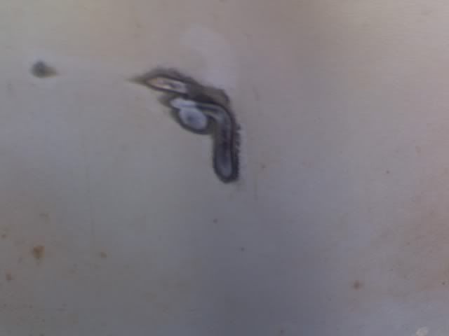

Yes you can, I did it. This is the only thing that resulted from it that was bad though..
Since the motor got raised up and the fan shroud/engine coolant bottle got raised up higher, the top of the coolant bottle rubbed the underside of the hood everytime the engine would torque. I gotta lower the shroud down just a bit.
