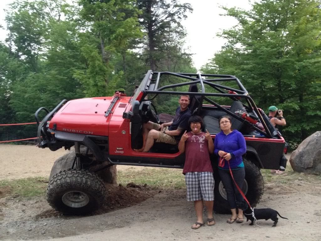

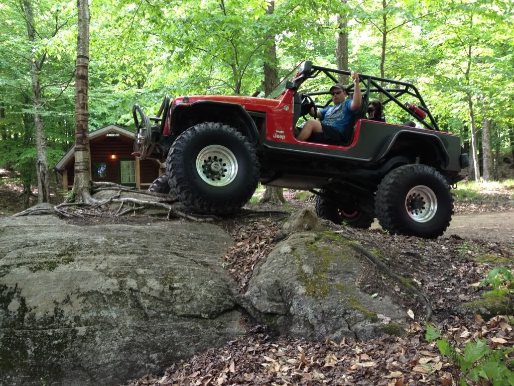

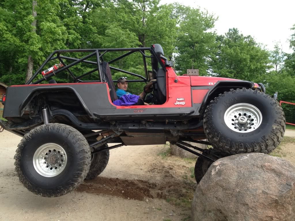

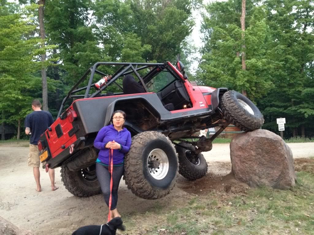

Here is a few pics from camping this last weekend
Thanks Again
Joe
