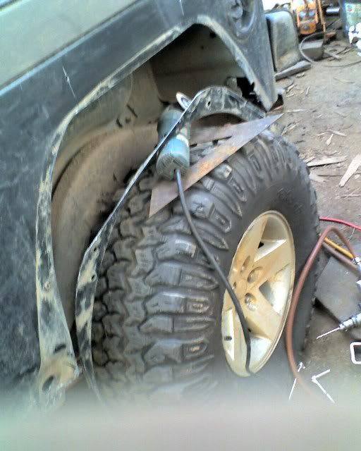

Well this is how mine came out. Of course I have to touch everything up paint wise and even out the flare just a hair. I haven't gotten to do the other side yet because it got too late and my grinder is loud =) My wife hates the flat fender look. :-[

Final. What do you guys think?

Looks pretty good up front Could stand to loose the milk jugs, they're really hanging out there by themselves and look even more out of place now. What's going on with that curve towards the back of the fender flair? Can that be easily contoured out to line up better or would that be some extra work? I'm curious as I'll be doing something similar when I have some time.
