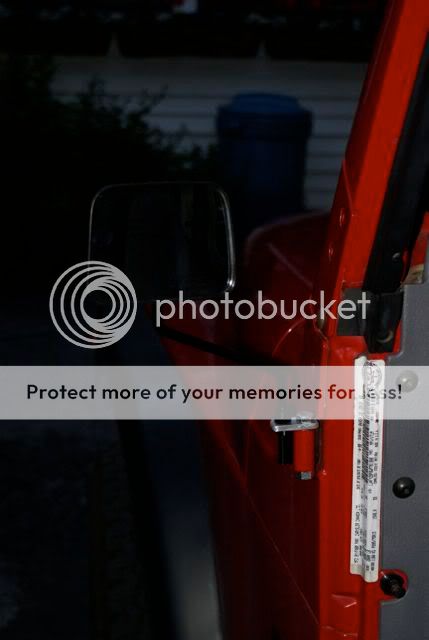

Originally Posted by bdock View Post
Heres the final pics of them.
I like that picture
Same concept.
Nice job.

Originally Posted by RiponredTJ View Post
I like that picture
Same concept.
Nice job.
haha ya man i like your mirrors good job.
good picture too
