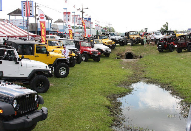

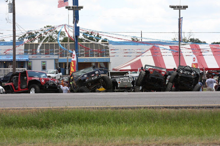

Did not get a whole lot done today because we had a show-n-shine at the local Jeep dealership. Had a good turnout and a lot of nice rigs, live band and boiled crawfish.
Really wanted to take my rig but did not want to rush this project. Do it right the first time.
