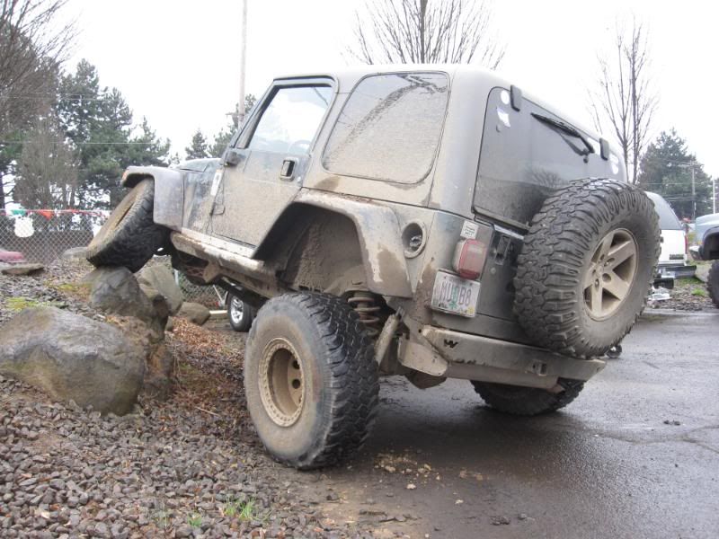

perfect pic of the tera mounts....

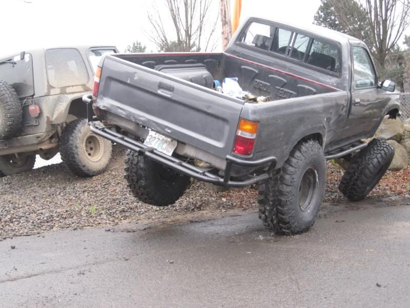

to be honest, I can't stand the xj's, they ride like tanks and have no flex in the rear, I can get evey bit the same flex from the front as the TJ if I remove the fenders, but the leafs will only fall so far with what unsprung weight it has pulling on the springs... here's a perfect example.
I have 14" travel shocks on all four corners of the toy, long chevy springs... and people brag about all the flex their yota's have...LOL
MY TJ has/had 2.5" rancho coils, 12" front shocks and 13" rear shocks in that pic, not to mention the shorter wheelbase... anyone who's thinking your RE 5.5" long arm will drive up on that rock without almost tipping over, or ANY out out of the box suspension kit you can buy.... you're very very wrong, it will not. BTW that rock is much taller than it looks..
