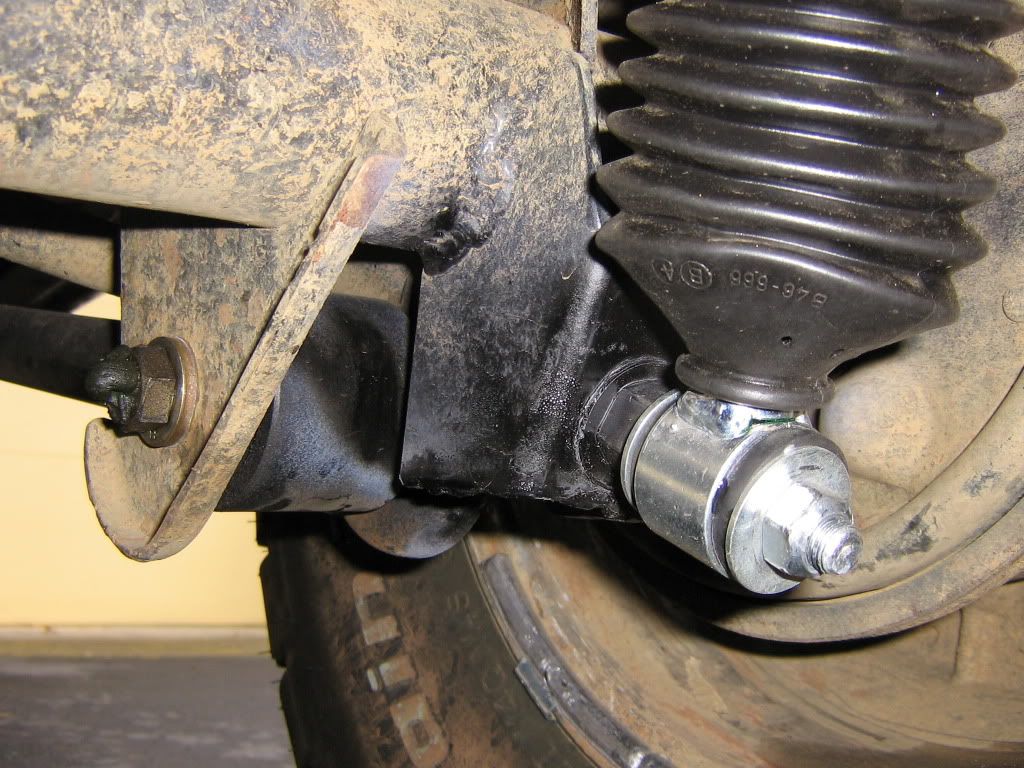

Upon further inspection, the lower shock mount (can't remember which side) did hit the shock body when flexing and put a tiny dent in it. Nothing that is harming the shock. I'll probably swap out the RE shock pins to a grade 8 bolt and space it out a little with a nut between the shock and the mount itself along with a washer on either side of the nut. Apart from that, a great cheap mod!

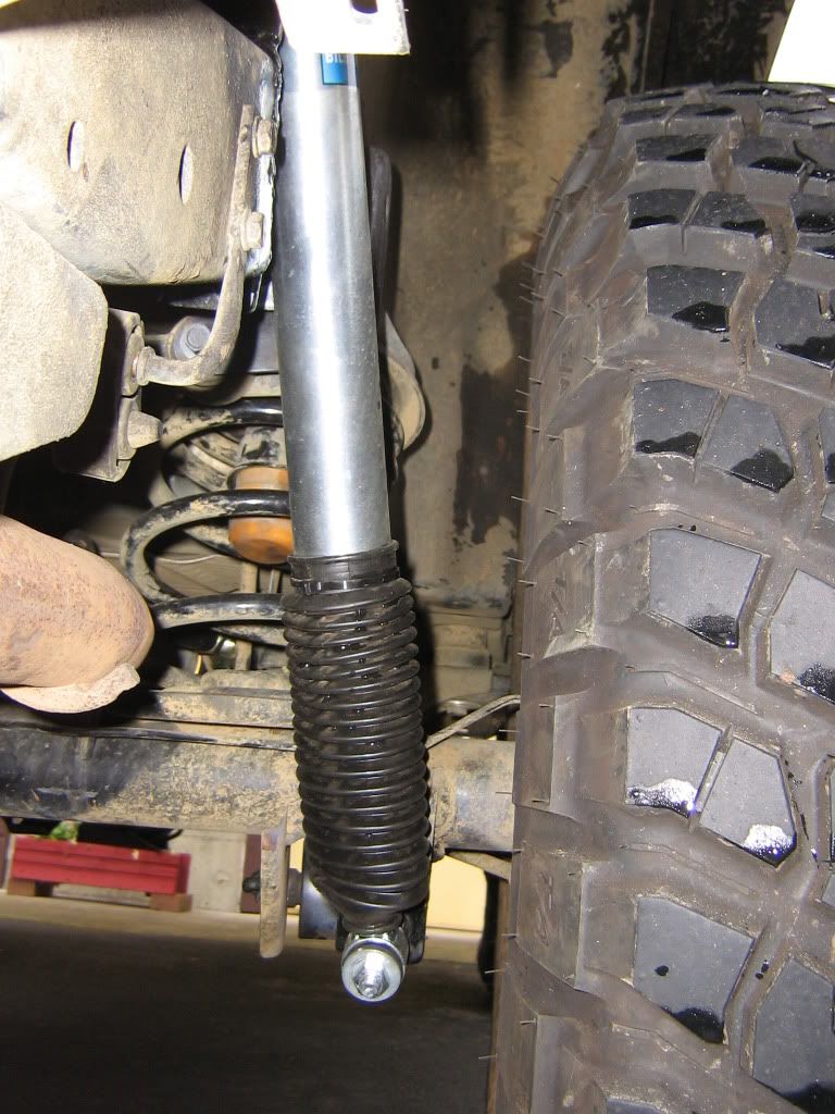

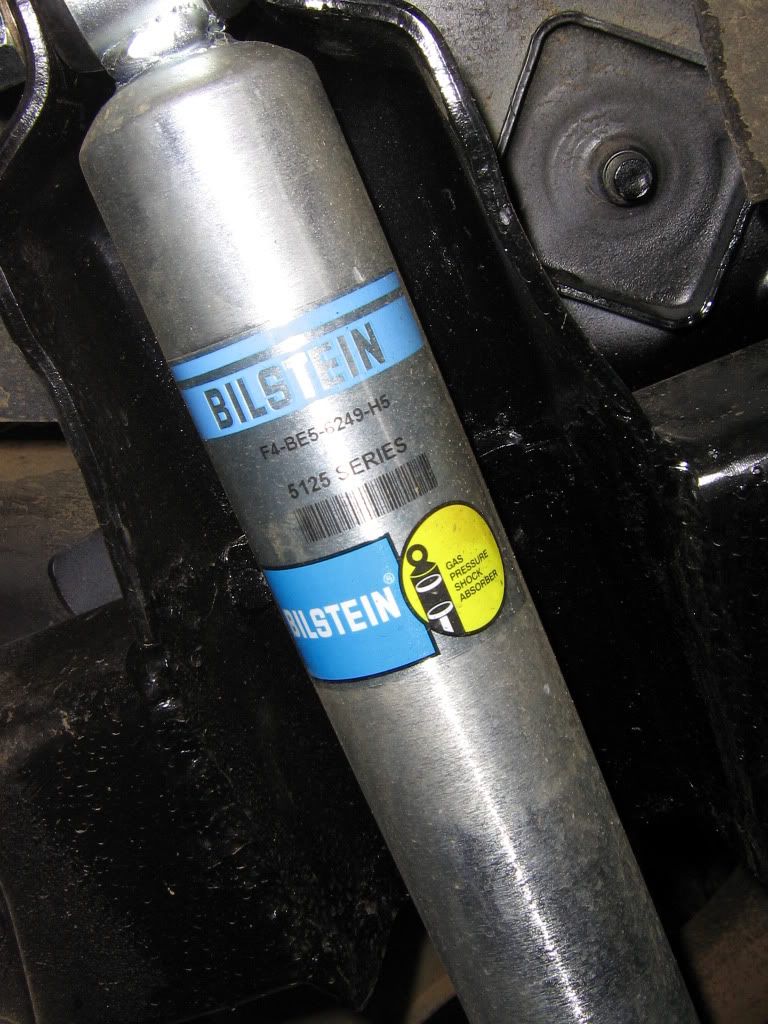

Thanks to Mudb8 (Dave) at Rob's Offroad, I have been outboarded. Here are the pic's...
