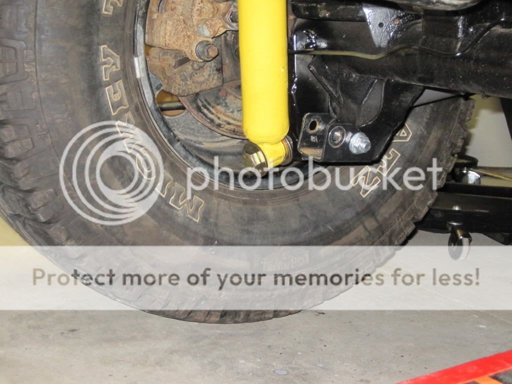

A few questions about this too. What part # is the Chevy shock stud/what were you saying about a grade 8 fine threaded bolt? Would the bolt be used in place of the Chevy part?
Have you had any problems with binding since the upper shock mount hasn't been moved? Just want to make sure these would be fine on a DD/weekend warrior. Thanks.

no binding or messed up bushings, most all the ones I've done are daily drivers.
using the 5/8" bolt in place of the chevy part is just as easy as the chevy stud. sorry I can't find a pic of how it's all put togther but you can see I used a bolt with washers on each side of the shock bushing, put a nut on and snugged it up just a bit beyond hand tight to slightly compress the bushing, put it through the bracket and used an acorn lock nut to secure it to the axle bracket, you hold the bolt head till the acorn nut is snug, then put a wrench on the bushing side nut along with the acorn nut to lock and tighten the bolt stud.... dbbd1 could prolly get you a pic since this one is on his TJ.

Shock Relocation
mudb8, I fabbed up the relocation brackets that you suggested in this thread and this is where I am at. Planning on gaining close to 5" of up travel when I am done

Im interested in setting up some shocks like this. I would like to get some more travel from the front, mostly down travel though. Im running the RC 2.5" lift, and actually wouldnt mind killing two birds with one stone. Get a smoother ride with some better shocks, and gain some articulation.
Any info on the cons of this setup? It seems like to me I could make a simple bracket and bolt it on with the lower control arm bolt or also weld it on.

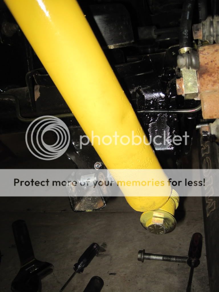

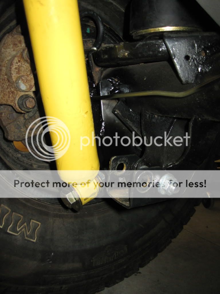

there are only cons if it's not clearanced to keep the shock body from hitting the bracket... one of the advantages is it keeps the shock bodies from hitting the frame during articulation with a 12" travel or longer shock, with about 7" down travel from ride height, you also end up with the drive shaft rubbing the auto transmissions...
heres one I did which keeps the bar pin and factory mounting, I simply cut it off and lowered it down 2".... well, there was a little more than that to the story..
