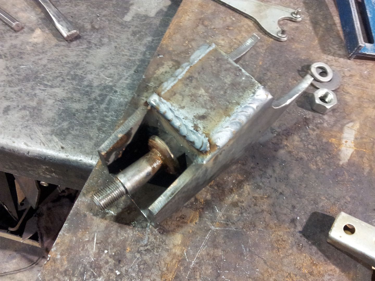

post #285 of 368 Old 10-01-2014, 11:29 PM Thread Starter
mudb8
want it rite or rite now?
mudb8's Avatar
Location: Estacada, oregon
Posts: 5,999
Some more variations....
11" balanced travel on 2" lift springs. Front bilsteins are 11.17", a jk application for 5-6" lift. Rear are 5125 11"
