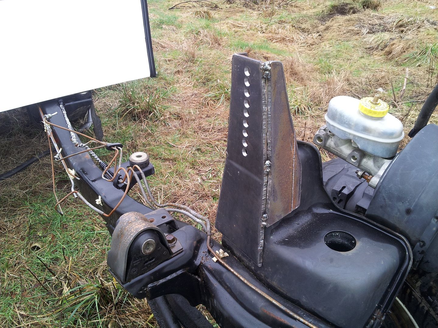

Theres a couple options for my stupid mounts....

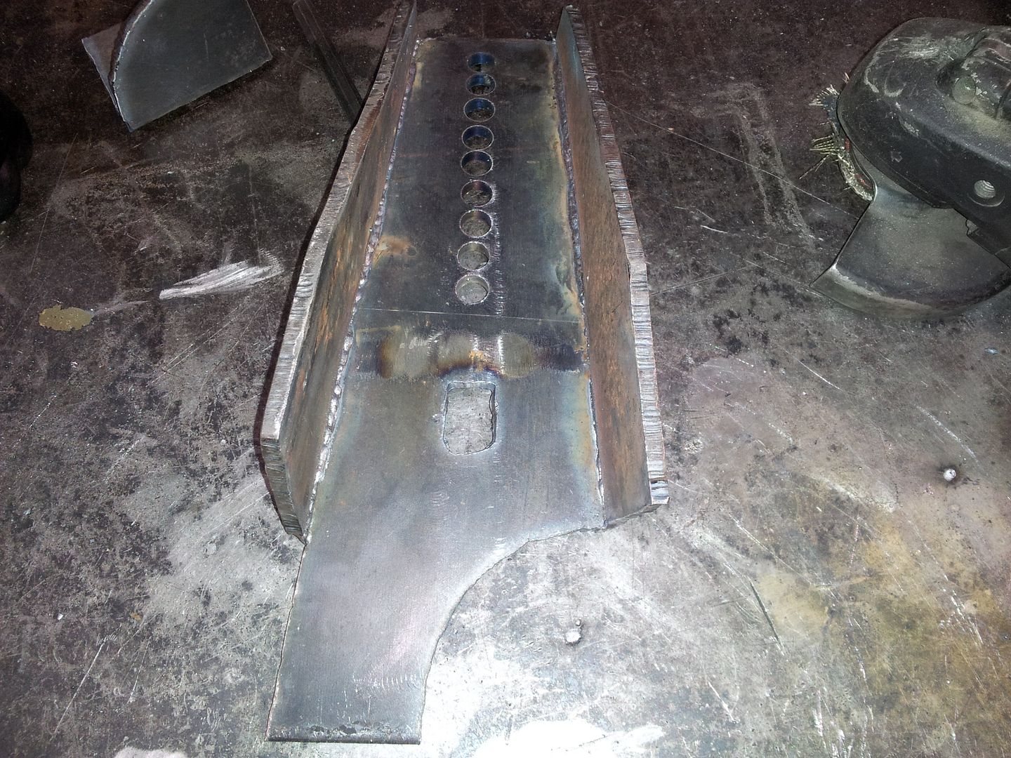

Hey mud, or anyone else for that matter, do you have a template with dimensions like this,
Originally Posted by mudb8 View Post
For this bracket?
Thanks in advance!
That one still lands where its supposed to
maybe just wording, but are you implying that the coils are "better" in the stock forward angled location
oh, x2 on the template for lower relocation HSS stud bracket, maybe even for 8.8 if available since larger axle tubes. lol, Just let us know where we send the cheque
Not implying at all. It is an 04 rubi with a stock d-shaft, if i relocate them to where popular belief says they belong, they will miss the stops just like they would with a cv shaft after adjusting the pinion angle. The belly hangs a bit due to its re/rubicon belly skid.
Ill see if one of the kids can put the mount in pdf to print.
I have 10 pairs of them cut and bent now, i need to pick up and check fitment.
Dang.. exactly what i need formy 04 TJ. Would you sell a pair of brackets?? If not, how about a template with dimensions?

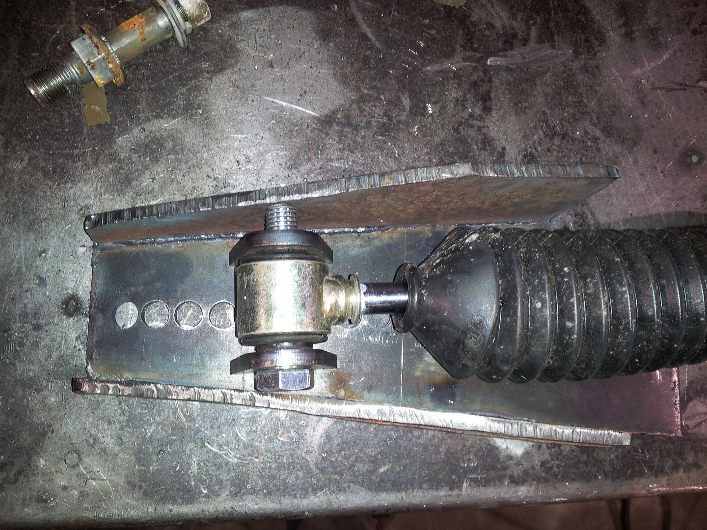

Im making these to accomodate stem shocks as well. This one is pretty tall. since i have highlined fenders there is alot of room.

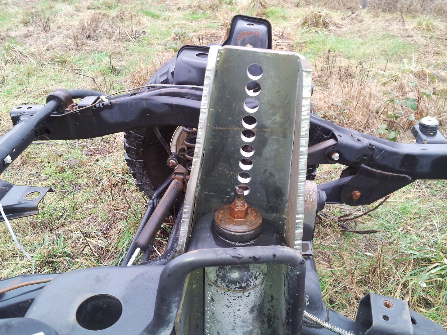

Originally Posted by aparke4 View Post
Sweet! Any plans on moding the lower mount? I had on my old xj cut the shock perch and welded two tabs just above the control arm mount. It's another easy way to fit a longer shock and eliminate the bar pins.
Nothing wrong with bar pins. If they are getting damaged it is from improper bumpstop extension.
Just takes a couple tabs to move the lowers, problem is keeping them off the frame and out of the calipers way. The factory lower ca's need reinforced or replaced.
Please dont misunderstand me, it is a good idea and works as long as a few things are considered beforehand. There are a few pics in this thread i have done.

Right on- I have metalcloak fenders and I think it might be easier to modify tower instead of lower shock mount. Plenty of room- I only need to get 1.5 to two inches more on my current 11 inch travel bilstein resi's to be happy. Currently have 3.75 up travel- barely enough around town!
I want to keep my stem uppers so I am looking at ford f250 tower and instead of tabs, trim the top and add a 1/4 plate across, drill a hole and bolt her up. More metal on shock tower to tie into anyways.
Yep, im not happy without at least 5" uptravel.
You prolly have about the same amount or a tad more of of unseated spring as the above pic with the 2.5" rc springs. The fox is an 11" on rock krawler 4" coils. It is already relocated 2" above tha stock mounting point and rubs th shock can on the tower where they punched it through.

Hey Mud, I recently put in my 2.5" rear springs and needless to say the shocks are a little long. As in I have 3" of up travel. New shocks aren't exactly in the budget right now so I was wondering if you could cut me a pair of these. I'd pay for the material cost and shipping.
-Jack
